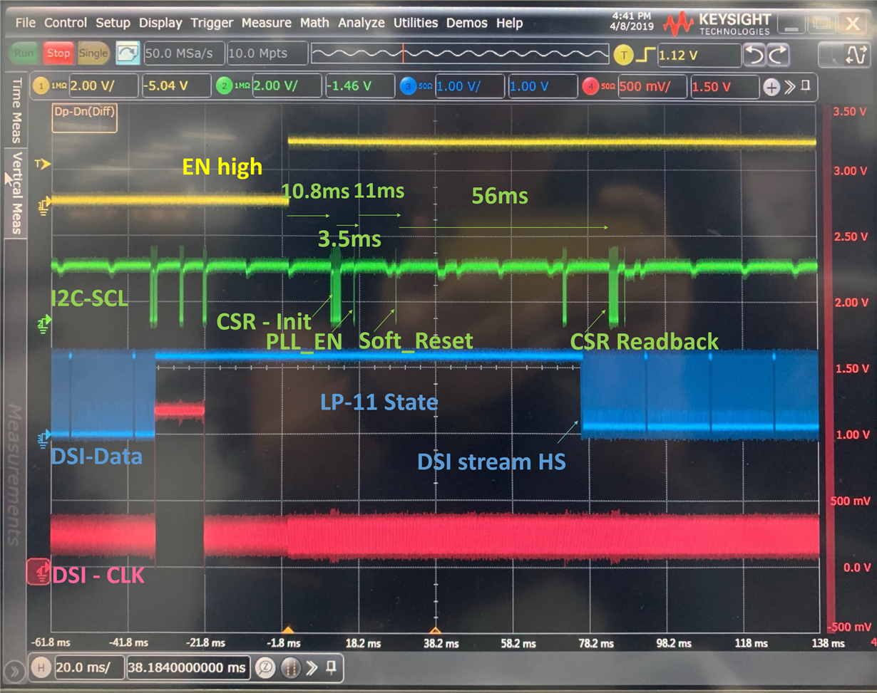

1. From recommended initialization sequence, all DSI input lanes including DSI CLK must be driven to LP11 state.
I’m afraid that our DSI only can output LP11 for DSI data lanes and DSI CLK keeps HS state. It doesn’t meet its requirement.
But, I checked recommended initialization sequence in SN65DSI85’s spec. It accepts DSI CLK in HS state and DSI data lanes in LP11 state.
Could we refer SN65DSI85’s initialization sequence shown below to bring up SN65DSI84?

2. From init seq1 to init seq4, all DSI input lanes including DSI CLK must be driven to LP11 state.
However, from figure 6, the drawing doesn’t meet from init seq2 ~4. Please help to check it again.
txn.box.com/.../uk2lh8osbn09p2fuvl48bz96ydqr7njg

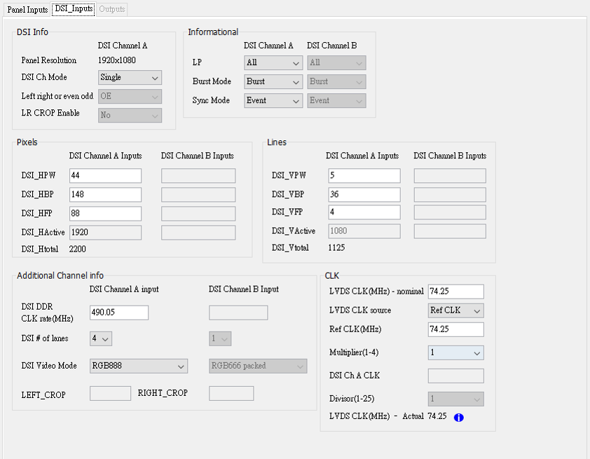

However, there is still one question about the setting of CHA_DSI_CLK_RANGE.
The real DSI frequency is set to 490.05MHz because it's set to multiplys 1.1 for Burst mode. (445.5MHz*1.1=490.05MHz)
So, either 0x59(445.5MHz) or 0x62(490.05MHz) should I set for CHA_DSI_CLK_RANGE (address: 0x12)?
1. Tooling setting (DSI frequency = 445.5MHz)
2. Tooling setting (DSI frequency = 490.05MHz)
BR,
Wilbur.
Hi Wilbur,

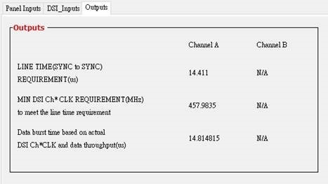

If the DSI CLK frequency going into the DSI84 is 490.05 MHz then the device should be configured as such. One issue with this frequency, though, is that there is a line time mismatch between the LVDS side and the DSI side, as you can see from the outputs window.
The line time on the LVDS side is 14.815us while the line time on the DSI side is 13.468us. So, the DSI CLK is significantly fast enough to enable DSI data to complete an entire line (from hsync to hsync) faster than the LVDS side can. This is fine for the test pattern since no DSI data is used, but it is problematic for actual DSI streaming.
To remedy this you have 2 options:
1. Use a faster LVDS CLK to make the line time match the DSI side. In this case you would need exactly 81.675MHz LVDS CLK:
For this you would also need to ensure that this frequency is within specification of your display datasheet.
2. Add more blanking to the DSI side to make the line time match the LVDS side. You would need to add 220 pixels to one of the blanking parameters (or split the 220 among all 3, it doesn't matter as long as you add 220 total blanking pixels) on the DSI side. Ensure your DSI source is actually outputting these parameters.
