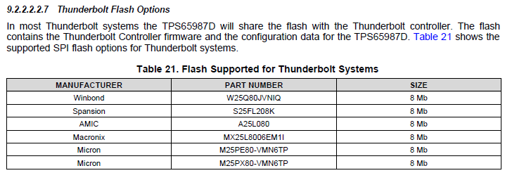

I believe minimum requirement for SPI flash for non-Thunderbolt application is the following.
Is my understanding correct?
- The flash memory IC must support 12 MHz SPI clock frequency
- The size of the flash must be at least 64 KB
- The minimum erasable sector size of the flash must be 4 KB
It seems 8Mbit is required for Thunderbolt application but I would like to confirm for non-Thunderbolt application.
