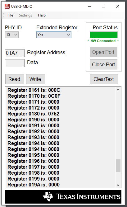

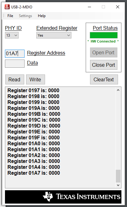

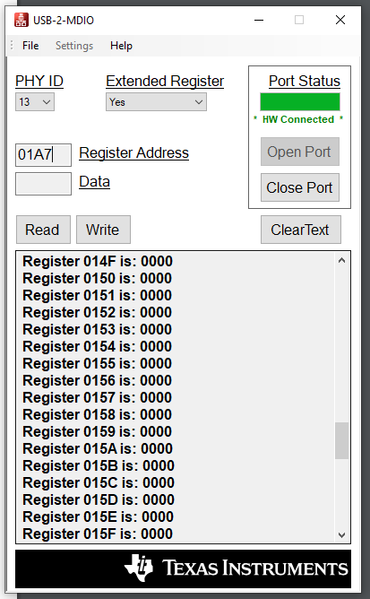

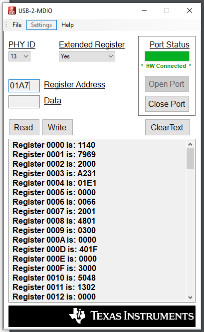

    As far as I understand USB-2-MDIO works with extended adresses. There are the registers values:
    As I said before LED0 and LED1 blink every 2 second, so if I read register 0x0005 when LEDs are off value is 0x0000, but if I read register 0x0005 when LEDs are on value changes to 0xCDE1
