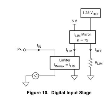

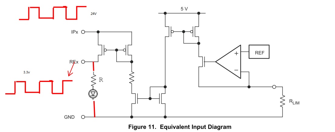

1. HVS885 IPx and REx relationship? I will take a ground resistance to generate a square wave, input to Mcu to do counter.
Explain:
a. In order to have an output waveform on REx, there will be a R connect to group . It will be affect Ilim?
b.  IPx enters a PWM 10/90 % duty cycle. How much difference will I get in the REx waveform?
2. Will REx be the same speed as IPx?
Exp: How long does Rex have Delay IPx?

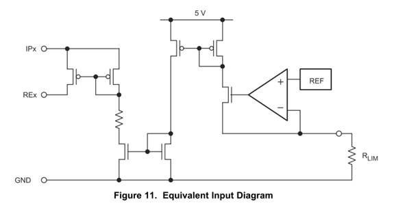

  • Hi user4786735,
    When IPx pin toggles, internally there is a feedback that will turn on the switch for REx pin LED outputs to turn high.

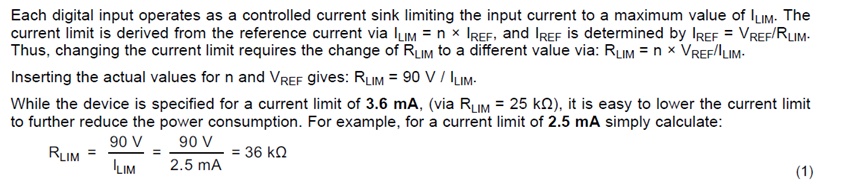

    On the cucrrent limit, I am assuming you meant R connected to ground? The Ilim changes will be affected by the Rilim value placed in your design per equation below:
    We do not have IPx to REx delay time information available. What is your application scenario, and coud you please advise why is this time delay important for your application?

  • Hi Helen
    I have PWM(24V) in IPx, I wnat to get same PWM in REx(3.3V) to do counter.
    Shawn
  • Hi user4786735,
    Unfortunately the time delay information is not available at this time. If you could provide your set up/schematics information, then I can order parts and evaluation board to perform this test.
    Thank you,
    Helen
