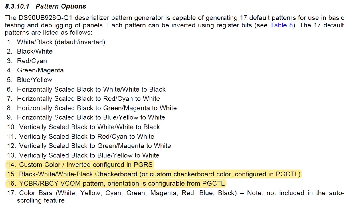

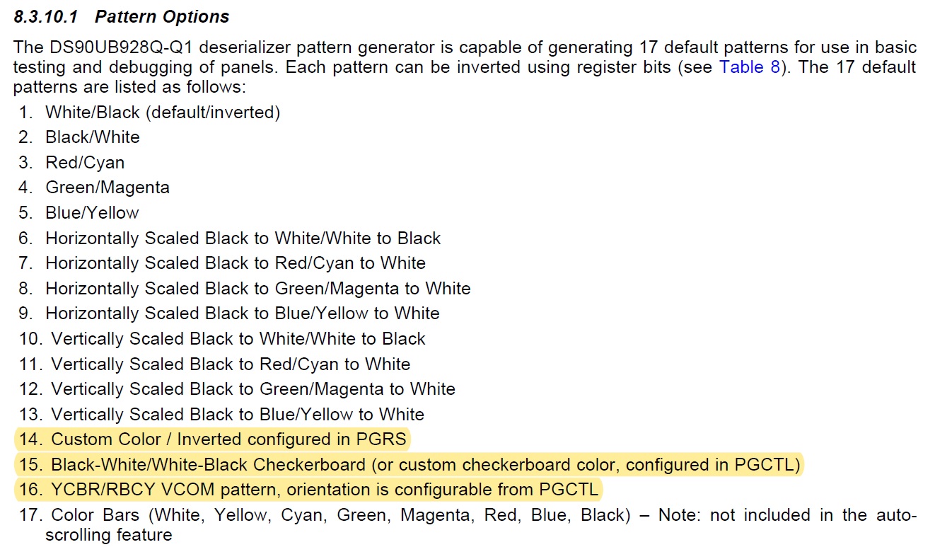

  • Hi Junqiang,
    in spec. page 22 patterns of DS90UB928Q BIST mode,
    hope to clarify what exact patterns below item14/item15/item16, or
    provide us with these 3 pattern-images.
    Warm Regards,
    Sauron
  • Sorry, we have no pattern image. But if you are using our pattern gen., you can generate these 3 patterns in your board, the output is the image that you want to get. attached is on pattern gen. app. note for your reference.
    thanks.
    Steven
