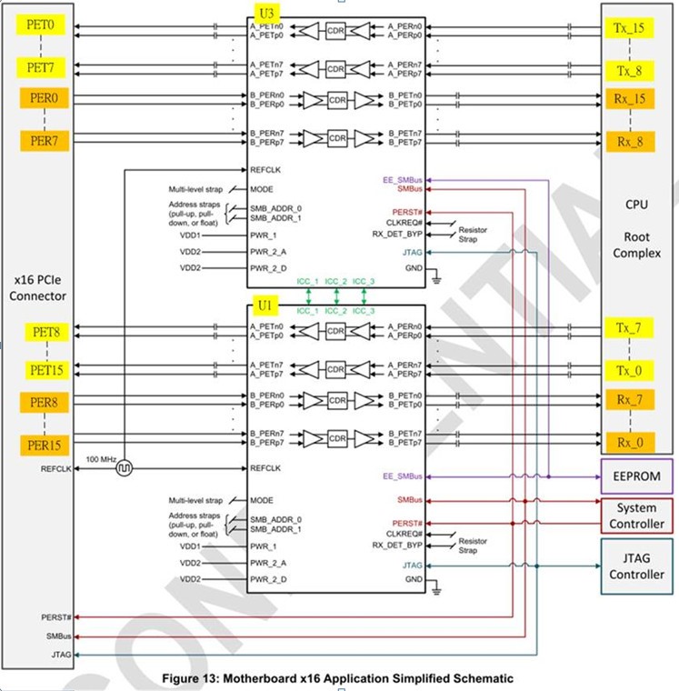

DS160PT801 lane reversal arrangement
Other Parts Discussed in Thread: DS160PT801
Hi Team,
Went to double check the lane reversal arrangement with you, CPU(15~0) to PCIe slot(0~15) need reversal X16 lane to meet X16(0~15) arrange.
If reversal by 2*re-timer(separate), the arrangement will result to 8~15~0~7?
Or these two re-timer have coordinate function to meet 0~15?
