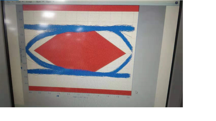

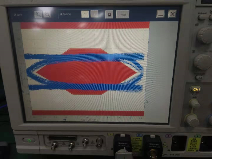

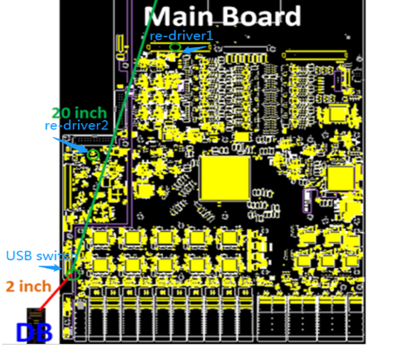

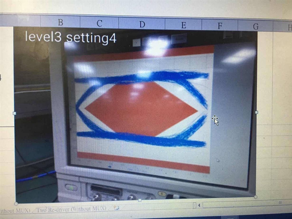

          Below is customer topology and they just put TUSB214 on re-driver 2 position close to USB port and re-driver 1 short now. They test EQ level 0~level 3 of TUSB214 but eye diagram still cover the eye mask on below. Has any suggestion to pass eye diagram testing? Thank you.
CPU-->PCIE connector
9 inch
PCIE connector-->re-driver1
2 inch
re-driver1-->re-driver2
10 inch
re-driver2-->USB port
10 inch
EQ Level 3 :
EQ Level 0
