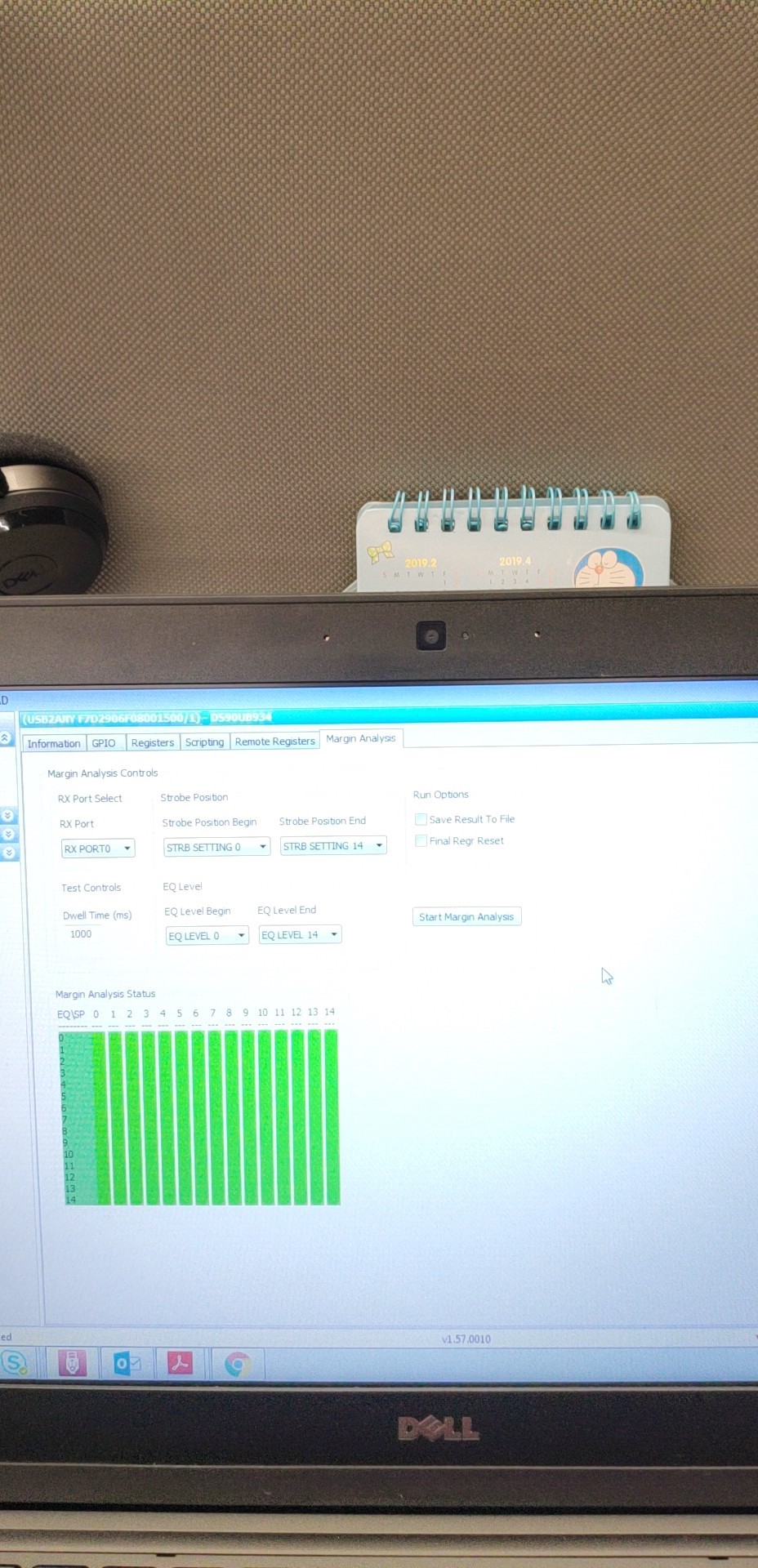

#1 Could you please kindly help to see if there have something wrong when we use the Margin Analysis to do some test on ds90ub934. As the attached file shows, the test result is so ideal, and we think it is unreasonable. we have tried to setting different time like 5s,30s, it still show all green strops. If we do not select the "save result to file", it will have effect for the test result?
Test condition: cable length 1.6m,  913 connected with 934

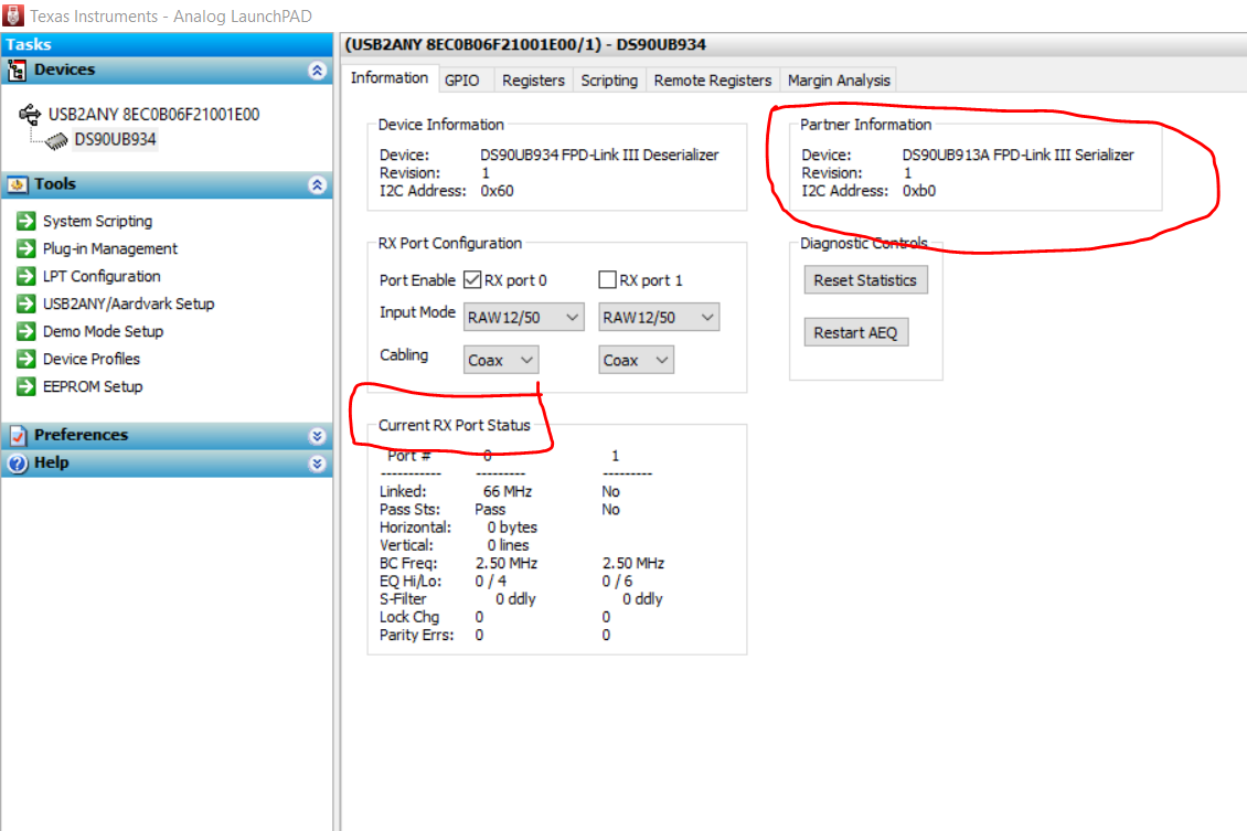

    I think your issue could be the clock source. The DS90UB933/934 chipsets use an external oscillator as the reference clock source for the PLL. This the recommended operating mode.  Please see DS90UB933 data sheet Section 7.4.1.
    I show below how the information tab should look like when external 66MHz clock source is chosen

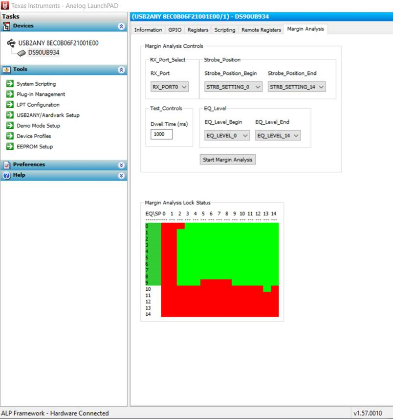

    Also, show below margin analysis results for 2m cable when using UB934/UB933 (note 933 is speed variation of 913 otherwise identical)
