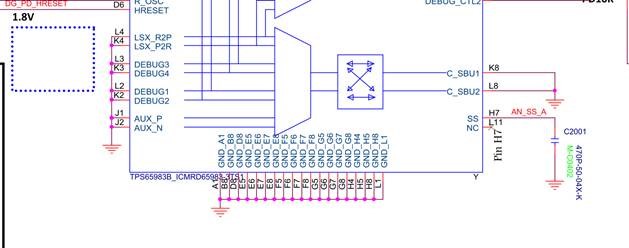

TPS65983B: TPS65983B for Intel Titan Ridge Thunderbolt design problem
Part Number: TPS65983B
The SBU1/SBU2 signal from the AUX signal pass to Alpine Ridge.
But Titan Ridge has directly bypassed PD controller.
Is firmware need to modify based on the design change?
  • Hi Chen,
    These configuration options will be automatically handled when you select the intel reference design that you are following when using the app customization tool. No other configuration changes would need to be made to support this.
    Thank you,
    Eric
