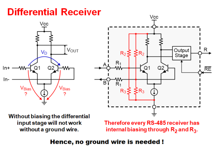

I have a question about receiver's internal resistor value.
This training video (https://training.ti.com/rs-485-overview
Part Number: THVD1450
Sorry, the question is not posted completely.
RS-485 overview training video says that every RS-485's receiver has internal resistor for bias function and attenuation.
In THVD1450 case, how much is the resistor value of internal resistor?
Could you tell me how to calculate?
Thanks and best regards,
Ryo Akashi
