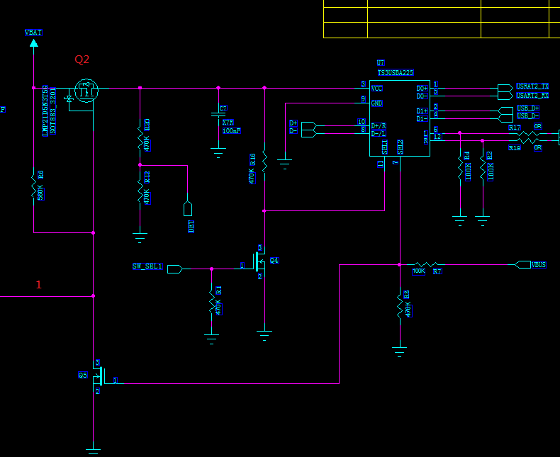

TS3USBA225: TS3USBA225: TS3USBA225RUTR From U7 pin8 and pin10 plus 20-20KHz, 100mV sweep signal, pin6 and pin12 have very high distortion, up to 30%.
Expert 2630 points
Part Number: TS3USBA225
When inserting Line in, Figure 1 is grounded.
The Q2 S and D poles are conductive.
The chip U7 Pin 3 VCC connects battery voltage 3.7V.
Meanwhile, Pin 11 SEL1 is also elevated through resistance R16.
Vbus is suspended, so U7 pin7 SEL2 is low. U7 switch to Audio mode.
