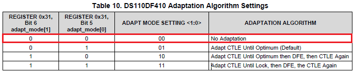

Hi Team,
My customer set "No Adaptation" mode, Register 0x31 bit [6:5] =00.

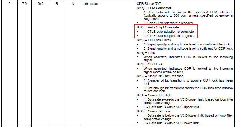

However, he has found Auto Adapt Complete bit (bit[6] of cdr_status) sometimes shows "1" or "0" after each power-on.
He said Auto Adapt Complete bit shows both "1" and "0" in random order although "No Adaptation" mode is set.
Is it possible case for DS110DF410?
I would like to ask just it is possible case or not.
