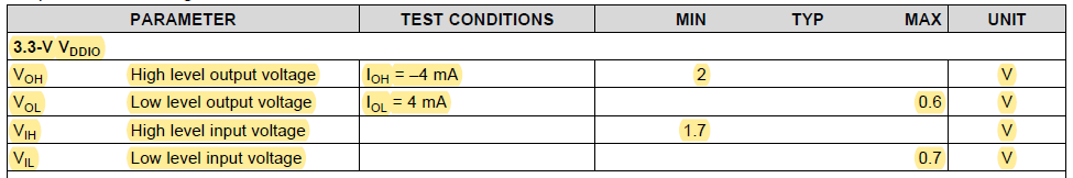

My customer is using our DP83867. The VDDIO of DP83867 is set to 3.3V. In our datasheet, it said INT pin has to be pulled up to VDDIO with a 2.2kohm resistor and MDIO pin has to be pulled up with a 1.5kohm resistor but the MDIO pull up power is not mentioned.
As the MAC side which communicates with DP83867 can only accept 1.8V logic level. So we want to adjust both INT and MDIO pull up power to 1.8V instead of VDDIO. And the 1.8V is from the MAC side internal power. So do you think this is OK for MDIO and INT?

    Pullup shall be done to VDDIO voltage. If MAC IO is at 1.8V, only you are interfacing 3V3 RGMII/MII of 867 ? THey have to be at same voltage level.

    My customer configures 83867 into SGMII mode, 100Mbps, VDDIO is set to 3.3V. The MAC side recommendation on MDIO pin and INT pin pull up power is 1.8V while our 83867 recommendation is pulling up to VDDIO which is 3.3V in customers' design. That's why they want to check if they can use 1.8V pull up power only for MDIO and INT but keep VDDIO as 3.3V.
    For INT, it is a output port and controlled by 83867. When 83878 outputs a low level, the INT pin is 0V. When 83867 outputs a high level, the INT pin is OD and the voltage is 1.8V due to pull up power is 1.8V. This is acceptable for the MAC side
    For MDIO, it is a input/output port and controlled by both 83867 and MAC. When MDIO is input and controlled by MAC, the input low level is 0V and the input high level is 1.8V due to pull up power is 1.8V. According to our datasheet, when VDDIO is 3.3.V, the 0V and 1.8V input level should be able to be recognized by 83867. When MDIO is output and controlled by 83867, the output level is 0V or 1.8V. This is acceptable for the MAC side
    So I thought it should be OK to pull MDIO and INT to 1.8V. Any comment from you is appreciated if I make something wrong. Thanks.
    Wayne
  • Hi Wayne,
    The design will be working at very corner condition. Incase the VDDIO drops below 1.7V, it may go in out of range spec. I sugges to have level shifters for robustness point of view.
    Geet
