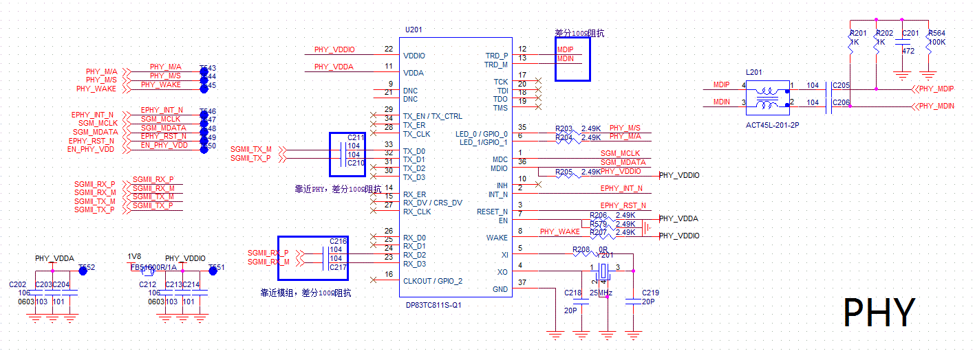

1, Could you please help me to review below schematic for DP83TC811S-Q1? Thanks. MAC interface is SGMII
2, How to set up Address of PHY? But I can't find introduction of PHYAD .
Thanks a lot.

DP83TC811_Schematic_Design_Review_Checklist.xlsxHi Wade,
For Phy-Address: you have to use Straps ( Pullups/PullDown) on RX_DV and RX_ER. Refer to Table 19 in datasheet. For schematics, review, kindly use attached xls to review the pin connections.
Geet
