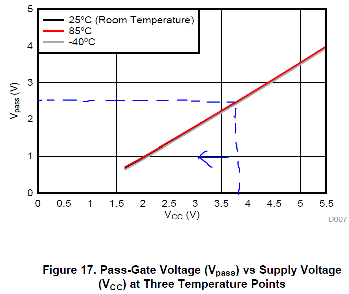

Hello
         if main I2C is 3.3V, slave 4 ch is 2.5V. Could TCA9545A support this voltage translation? Thank you.
BR
Patrick
  • Hey Patrick,
    That will work.
    You can see below your lowest value pass FET value is 2.5V which means TCA9545A requires a Vcc of ~3.7V or less in order to support level shifting. You can either supply TCA9545A with Vcc=2.5V or 3.3V and it will work.
    -Bobby
