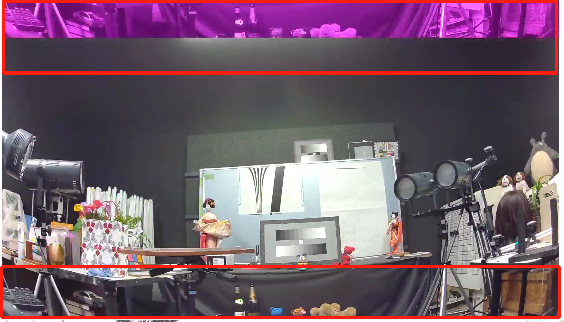

     We  are using DS90UB954-Q1  to connect one  camera module with  Coax,  camera  is running 1080p@27fps,there will  flick ,flick is in attachment,could you help  point out  what's the possible reason and how to solve it ?

  • Hi TI Team
    We have use internal pattern generator both on 954/943, camera flick issue never happened.
    After that, we have disable adaptive EQ, this configuration will improved camera flick issue,but this solution only reduce the probability of recurrence, flick issue still happened.
    Could you provide AEQ register configuration to us? we uses coax cable with 1.5m length.

  • Hi BR,
    for 1.5m cable it is recommended to use the default register values for AEQ.
    You have said, by using the Pattern generator on the 953 or the 954, the issue never happened. This indicates that you have probably wrong settings on the Image sensor.
    Also please check the used PCLK and the power supply rails of the imager.
