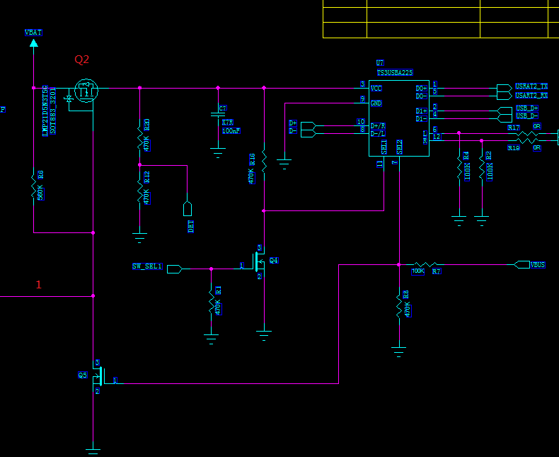

TS3USBA225: U7 switch to Audio mode. Add 20-20KHz, 100mV sweep signal between pin8 and pin10, Pin6 and pin12 are highly distorted, up to 30%.
Expert 2630 points
Part Number: TS3USBA225
If attached
When inserting Line in, Figure 1 is grounded. The Q2 S and D poles are conductive.
The chip U7 Pin 3 VCC is connected to the battery voltage of 3.7V, and Pin11 SEL1 is also raised through resistance R16. Vbus is suspended, so U7 pin7 SEL2 is low. U7 switch to Audio mode.
