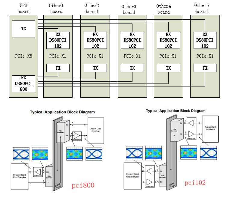

Hi Team,
In my Design,The system includes 1  CPU board and 8 other boards,Data interchange with PCIe bus 。in each board we add PCIe Repeater (CPU board use DS80PCI800 ,other board use DS80PCI102
Diagram as follows)
Q1: In application,Is there any problem?(CPU board use DS80PCI800 ,and other board use DS80PCI102 , DS80PCI102 's Tx are NO connect )
Q2:DS80PCI800  include 8-channel repeater,Is it possible to communicate independently without interfering with each other?
