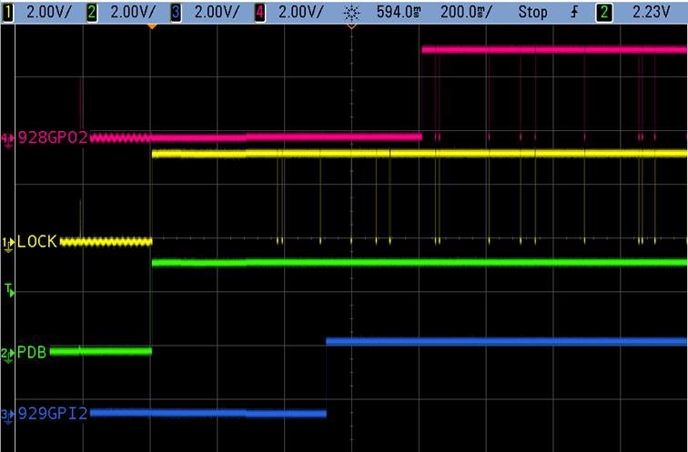

Hi sir.
We use UB928 to set GPIO 2 to GPIO mode. But we measured the noise before setting GPIO 2 to GPIO mode.
Until UB929 and UB928 link and set to GPIO mode after about 2 seconds noise will disappear. Can this Noise be solved?
Channel 1, UB928 IDB pin(Power Enable)
Channel2, UB928 GPIO2

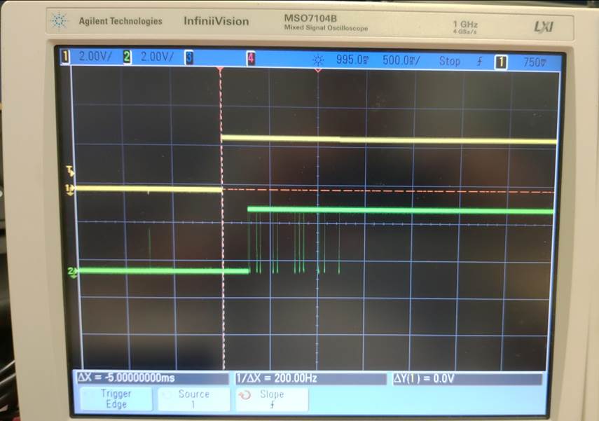

  • Hey AJ,
    Can you also probe LOCK on the 928 during this startup?
    Casey
    If you are trying to control the 928 from the remote Serializer, the forward channel, and LOCK status are needed.

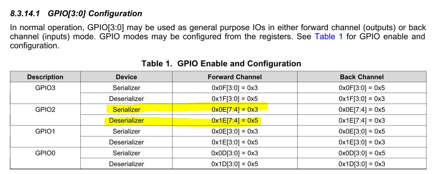

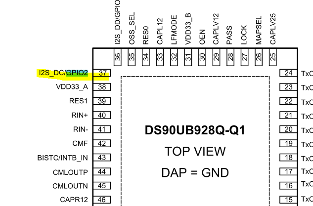

    GPIO2. if you use the OEN input Low, and OSS_SEL Low, the GPIO is forced low through Table 5 in the datasheet.
    GPIO2 when the Forward Link is active, or the Local I2C (at the 928 is active), can be changed through register controls.
    pg46 datasheet, Register 0x1E has the GPIO2 control, on power up GPIO2 is in the I2S function, it can be reprogrammed as a GPIO through this register, or controlled by the remote serializer.
    Before you reprogram register 0x1e, the GPIO2 is a default power on function.   If you want to not see the pulses on GPIO2, set OEN = 0, then program GPIO2 for output, with a logic '0'. then set OEN = 1.

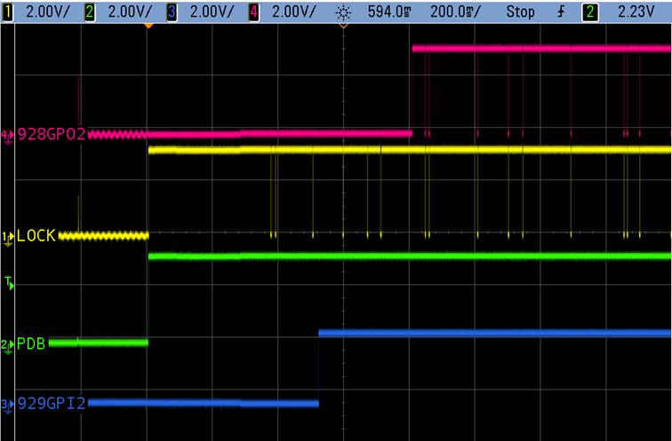

  • Dear Joe / Casey.
    Good day.
    It seems that the noise of GPIO 2 is affected by LOCK. After about 2 seconds, LOCK is stable and there is no noise. GPIO 2 is also normal.
    Why does LOCK have noise at the beginning? is this normal? Can this problem be solved? Thanks for kindly help~
    Although you asked about GPIO noise, in your last oscilloscope snapshot, it is not normal to have a device continue to be out of lock
    and in lock. You need to investigate what is causing the loss of lock, and fix that first. We expect LOCK to assert several ms after PDB
    is releeased. After the initial 0->1 transition on lock, there appears to be a place where the 928 GPIO2 is programmed to follow an FPDLink input
    GPIO or I2C command. We can't tell the GPO2 is being directed as a 0 during the non-lock period, because it is already a logic '0'.
    GPIO1 and 2 are shown in Table 8, if the GPO2 is forwarded from the serializer, when Lock is lost, its possible the Link is retrying to establish control.
    Joe Quintal
