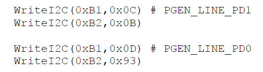

    I have some question about E2E's feedback.
    You can find details on the PATGEN operation in the 953 datasheet section 7.6 along with a code example for 1080p @ 30fps.
    To increase to 60fps, half the line period field.
   Is code changed  in PGEN_LINE_PD1 & PD0?
How to change the value of 30FPS to 60FPS?
What is the value to be given?
