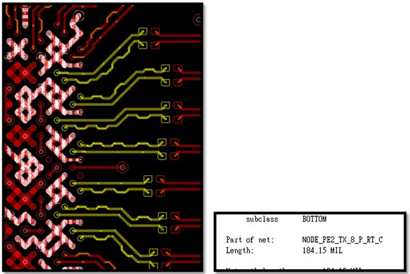

Hi Team,
Any constraint about trace length from DS160PT801 to cap? The spec didn’t write about this.
Please help to check and provide the related document.

Hi Daniel,
There is no constraint on our side. I would recommend a minimum of 150 mils just to have enough space for assembly, rework, or device probe.
