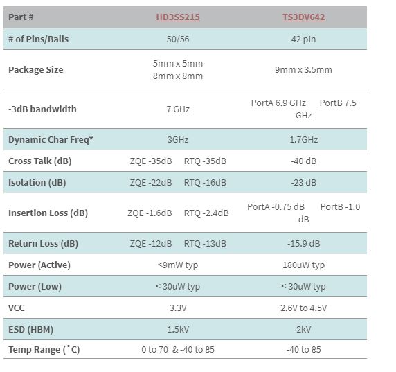

What's the difference between TS3DV642 and HD3SS215?
What's kind of input source or application can regard this two are as same function?
Can you share comparison table between them?
