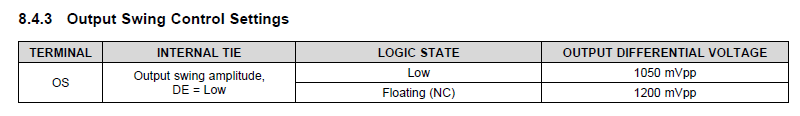

Hi team,
whether the OS pin can be pulled up or not? if can, what's the output voltage range?
Thanks.

hi David,
if it's 2 state input, it should accept the pull up, the pull up may belong to float. could you please help check it. Thanks.
