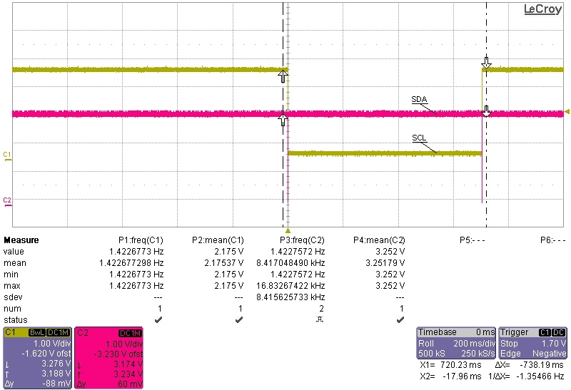

I use DS90UB913A-Q1 I2C Reverse channel update the camera firmware,but sometimes I2C will be lost, causing the firmware update to fail.
I prepare 10 samples to test. But found 5-6 pcs I2C have Issue.
If I swap the normal module with the 913 of the exception module, the I2C problem will follow.

    what do you mean by "If I swap the normal module with the 913 of the exception module, the I2C problem will follow."?
    -->If I switch the 913 IC that works correctly to the abnormal camera module, this will make the I2C loss disappear.
    So,i think 913 is the source of the problem.
    Can you monitor LOCK on 914A and see if the LOCK also goes low at the same time?
    -->The LOCK Keep High
    Can you monitor the power supply pins on the 913A and see if any relation?
    -->The Power supply pins are Normal

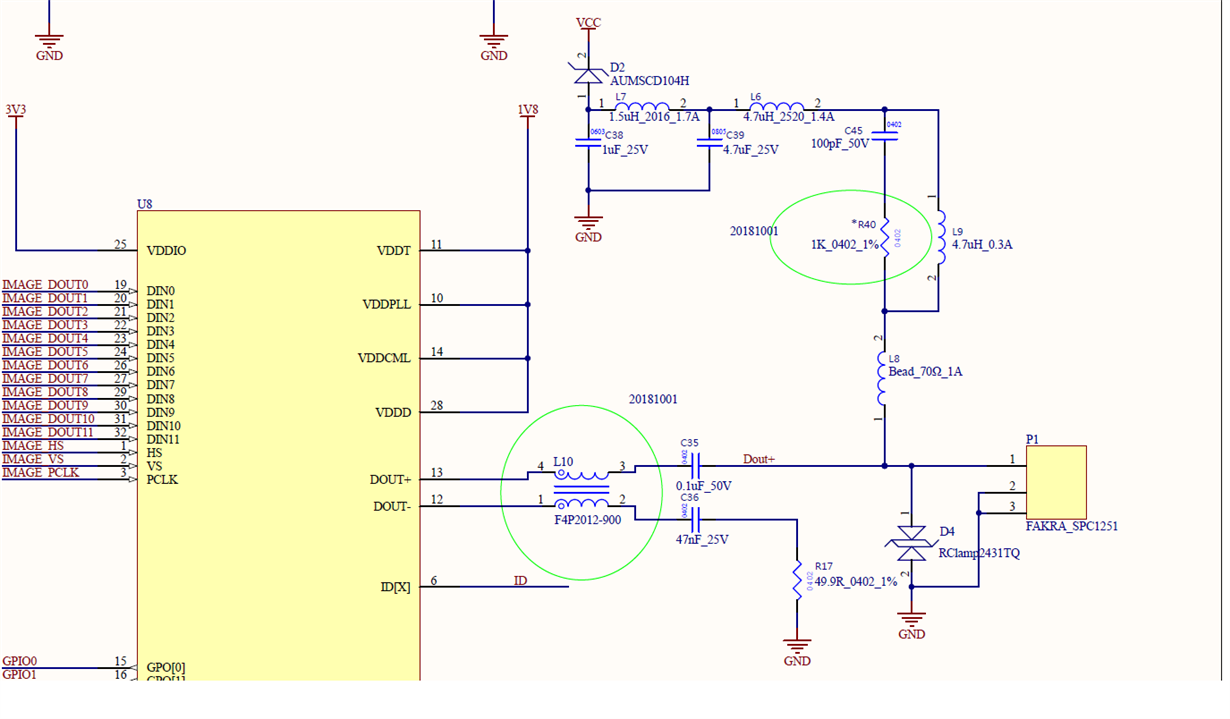

  • Hello Waber,
    if you believe this is a device issue, please contact you local TI sales representative.
  • Hi Hamzeh,
    I work with Waber and confirmed the issue is cause by POC power interference to the back channel. We discuss connect the POC and use external power source. The issue disappear. Would you help review our POC circuit attached below, any improve suggestion?
  • Hello PYTsai,
    thanks for the info.
    Yes your PoC filter is not sufficient for Back channel frequency because it is messing the large Inductor. Please refer to this application note.
    Also you can remove the Common Mode Choke because you are not using differential. Also you need to replace the FB with one with higher Impedance at high frequency, 1.5K ohm @ 1GHz
