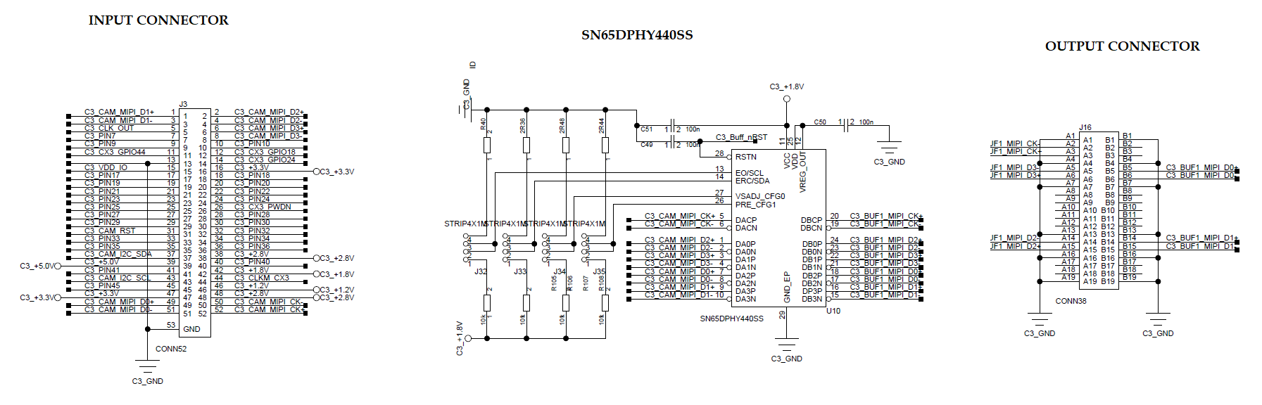

  • I didn't  check the output yes because today I didn't  get the oscilloscope, but tomorrow I will do for sure.
    Regarding the register, in my schematic I used jumpers for having the possibility to select high/middle/low voltage as input of EO/ERC/CFG0/CFG1 pins.
    I am using the middle voltage for loading at the startup a "compromise" as default values..
    keep in consideration that I have few inch of traces with 100 ohm impedance. So I think we dont need a big emphasis.
    below you can see the schematic: at the input connector we have the CSI2 signals from the camera.
    then we have the repeater, with the jumpers above mentioned and inputs 01 and 23 swapped.
    when we have the output connector where the receiver is connected.
    What I have already checked is the power supply at 1.8V and the generated voltage at the VREG_OUT/VDD pins which is at 1.2V
    we have a big project which depends on this buffer, so I really need to make it working.
    any idea is welcome
    thanks again
    stefano
  • Stefano
    You may need to change the 100nF on RESETn to 200nF to make sure the DPHY440SS is being reset properly.
    The CCI does not go through the DPHY440SS, how do you connect the CCI bus?
    David

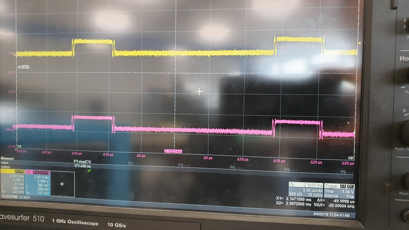

  • Hello David,
    here below pic from the oscilloscope on one of the lanes:
    I dont know what these signals are, but I can clearly see that the output (purple) follows the inpit (yellow).
    tomorrow I will try to modify also the registers value: today I had an hard time to make the I2C working starting from a FTDI device, but at the end I got it!
    if meanwhile this picture gives you some idea, please let me know.
    as additional info, I saw the same signal when using the board without buffer (direct connection), so I am quite sure the csi2 signals look like that.
    many thanks for your support

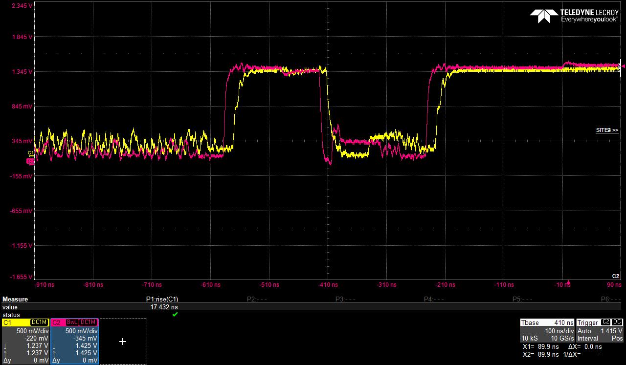

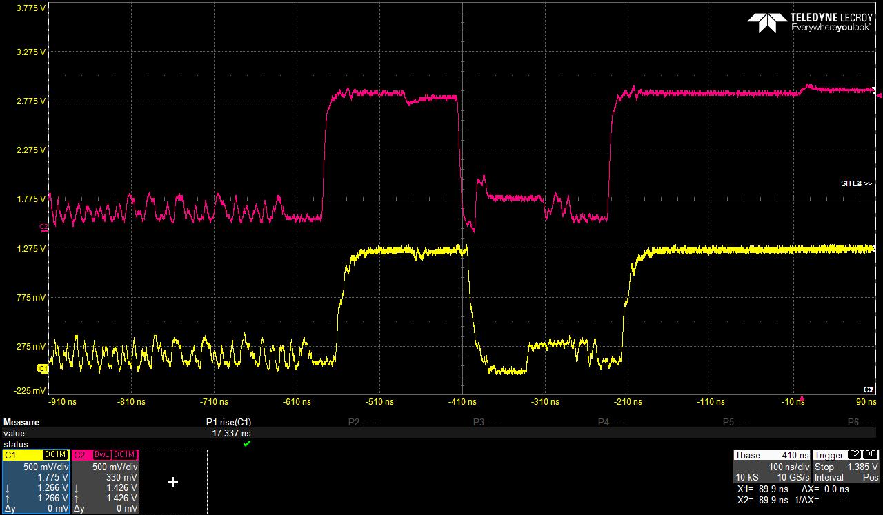

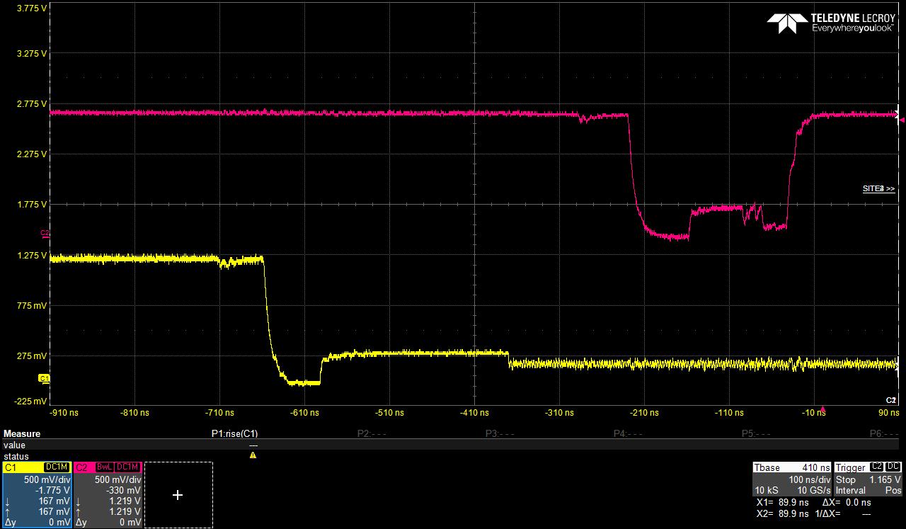

  • Hello David,
    today I made several trials.
    I have added 100nf on the existing 100nf capacitor for the reset pin.
    I have programmed registers 0x09 and 0x0E as suggested (and also read back to check the programmed values).
    But I still can't  get the device working...
    I have some screenshot from the scope:
    due to the missing differential probe I wasnt able to get a clear signal, but it should be enough for some understanding.
    img1 - data0P_in and related output overlapped
    img2 - data0P_in and related output not overlapped
    img3 - data0P and clockP outputs
    img4 - clockP output better zoom and time scale
    any idea ?
    many thanks again and best regards
    Stefano

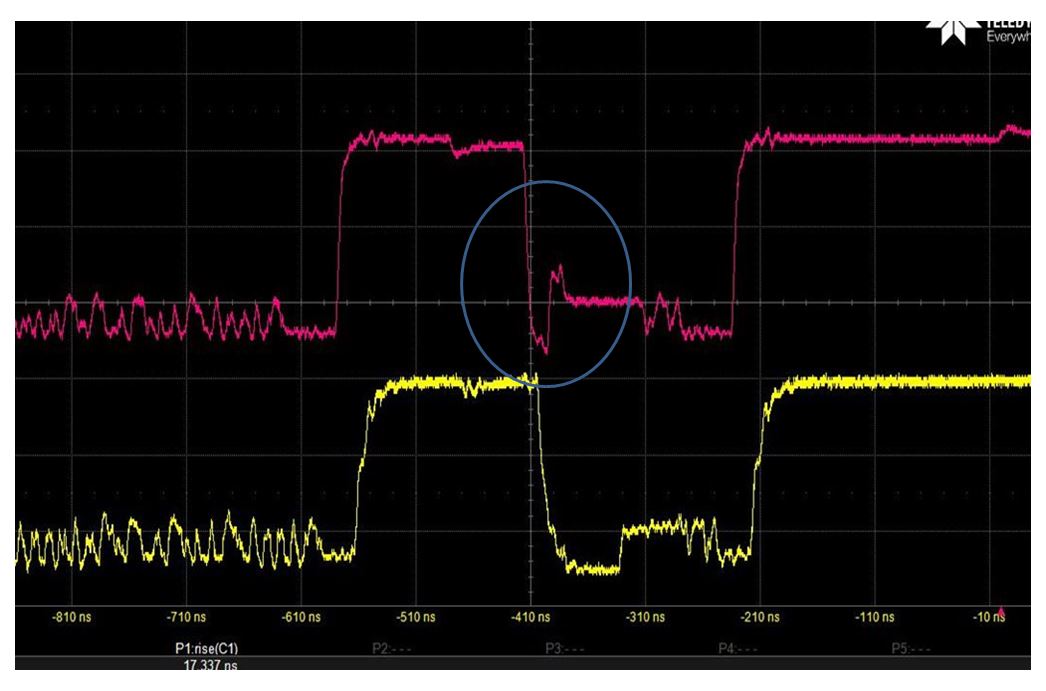

  • Stefano
    Looking at the waveform, one of question is the HS Zero time as circled in the picture below.
    Per the MIPI DPHY spec, the THS-PREPARE + THS-ZERO is minimum of 145ns + 10UI, and THS-PREPARE minimum is 40ns + 4UI, and maximum is 85ns + 6UI. Even if I take the minimum of THS_PREPARE + THS-ZERO and subtract max THS-PREPARE from it, the circled area seems to be less than the THS-ZERO. You should able to change the value in the camera register.
    The second thing to check is the setup and hold time as shown in Figure 2 and Table 6.7 of the DPHY440SS datasheet and make sure there is no timing violation.
