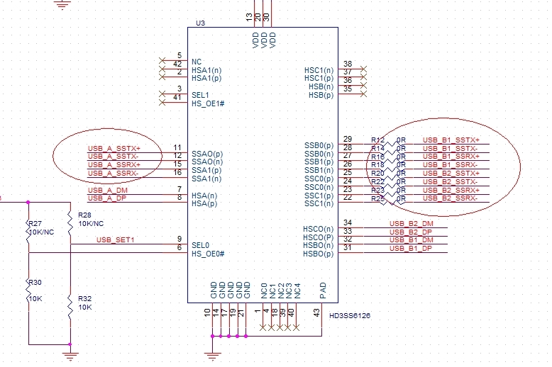

Hi
According to the pins on the specifications, the differential signals TX + /TX - and RX +/ RX - of USB 3.0 input and output are crossed on LAYOUT.
Can we exchange the differential signals TX +/TX - and RX + /RX - of input and output so as to avoid through-hole on PCB?
