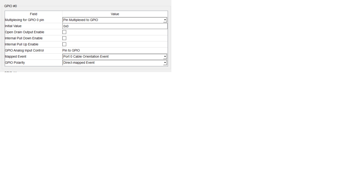

Hi TI,
I am using GPIO0 of TPS65987D to control SEL pin of HD3SS3212. How could I configure it in the Application Customization Tool below? Thanks!
  • Hi Fan,
    The application note "TPS65987/88 GPIO Events" at www.ti.com/.../slvae11 will describe how to configure an event to control the GPIO.
    As an example, for the event you attached, "Port 0 Cable Orientation Event", Table 1 in the note shows the GPIO will be:
    -Asserted high when plug is connected upside-down.
    -Asserted low when the plug is connected upside-up or disconnected.
