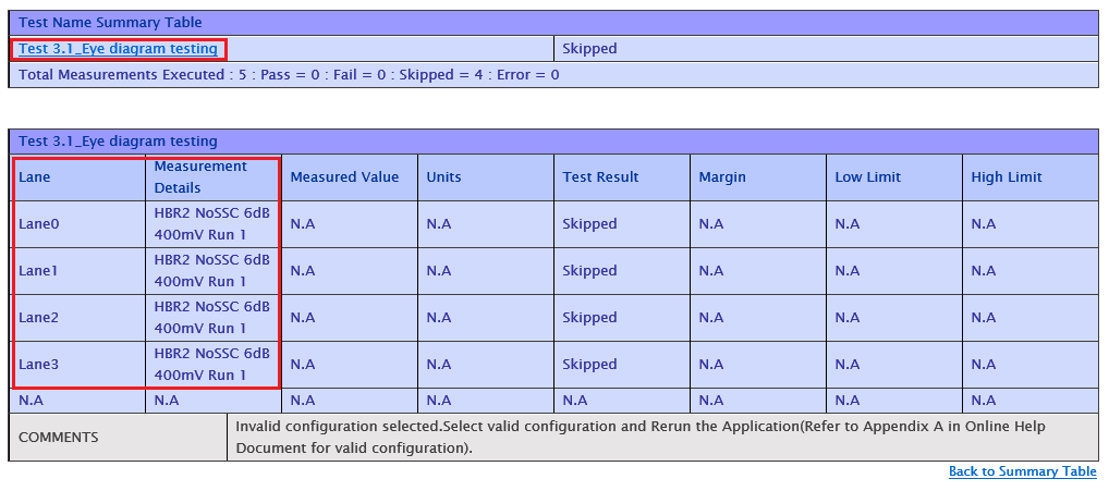

My customer test DP130 with several Gain setting, however, they found there was skipped test at 6dB 400mV setting.
Their platform is intel coffee lake.
Others setting such as 0dB 400mV, 3.5dB 400mV, 6dB 600mV were be able to test even the result are pass or fail.
Attached files are test report.
Can you help to advise what should we do to test under this setting?

    However, per test report, it seems for eye diagram testing of Lane0~lane3.

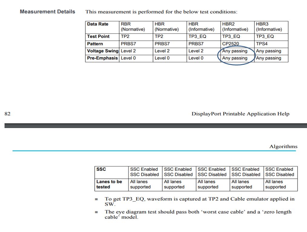

    My understanding is that if the pattern fails and user selects Skip test if validation fails option then status of that test will be ‘Skipped’. In case the user selects ‘Reacquire’ and it fails to acquire good pattern in 10 attempts, then that pattern will be skipped from acquiring.
    But for HBR2 eye diagram, you can use any SWING and Pre-emphasis setting, and from the report, you do have SWING and Pre-emphasis setting that can pass eye diagram, so I am not sure why you would choose 400mV 6dB option for the test.

    As your information for HBR2 testing, "Any passing" is OK.

    After discuss with customer, they can accept pass or fail since both of them are "test result", but skipped was not.
    And, customer did all test but these 4 items always be skipped even they did not set any skip related setting.

    I don't know why the Tek scope will go through different combination of SWING and Pre-emphasis level because the DP1.2 CTS spec says any SWING and Pre-emphasis combination can be used to pass the test. I think with 400mV, 6dB, it is possible that the eye is being over-equalized, and In case the Tek scope fails to acquire good pattern in 10 attempts, then that pattern will be skipped from acquiring.

    Different system would have different design. Do they have Keysight scope? It would be good if they can run the same test with the Keysight scope and see if the test is passing or failing.
    6dB could cause the signal to be over-equalized, and 400mV perhaps is not enough amplitude to open up the eye with 6dB pre-emphasis.
