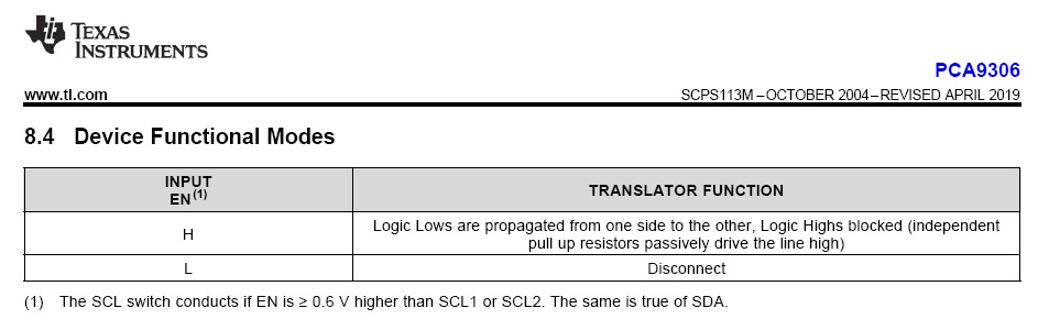

    5> <Spec description>High-impedance SCL1, SDA1, SCL2, and SDA2 pins for EN = Low
    <Spec description>EN = High =>Logic Lows are propagated from one side to the other, Logic Highs blocked.
    <Spec description>Logic Lows : low-resistance connection exists between the SDA1 and SDA2 ports

    "<Spec description>EN = High =>Logic Lows are propagated from one side to the other, Logic Highs blocked"
    Can you tell me where you see this in the spec? When enable is high, the SDA and SCL will pass lows. When SDA/SCL is a logic high, both sides should go up to the pull up voltage. The high is provided by the pull up resistors, the low is driven through the PCA9306 device.

    5> Just curious why i see 3.3V on side 2 without installing customer side.
          Actually , customer will provide pull up register also.
         "Blocked" confuse me on this case.
          orgianl version SCL1 = SCL2, SDA1 = SDA2 seems can explain this case.
          Here is the picture from spec
