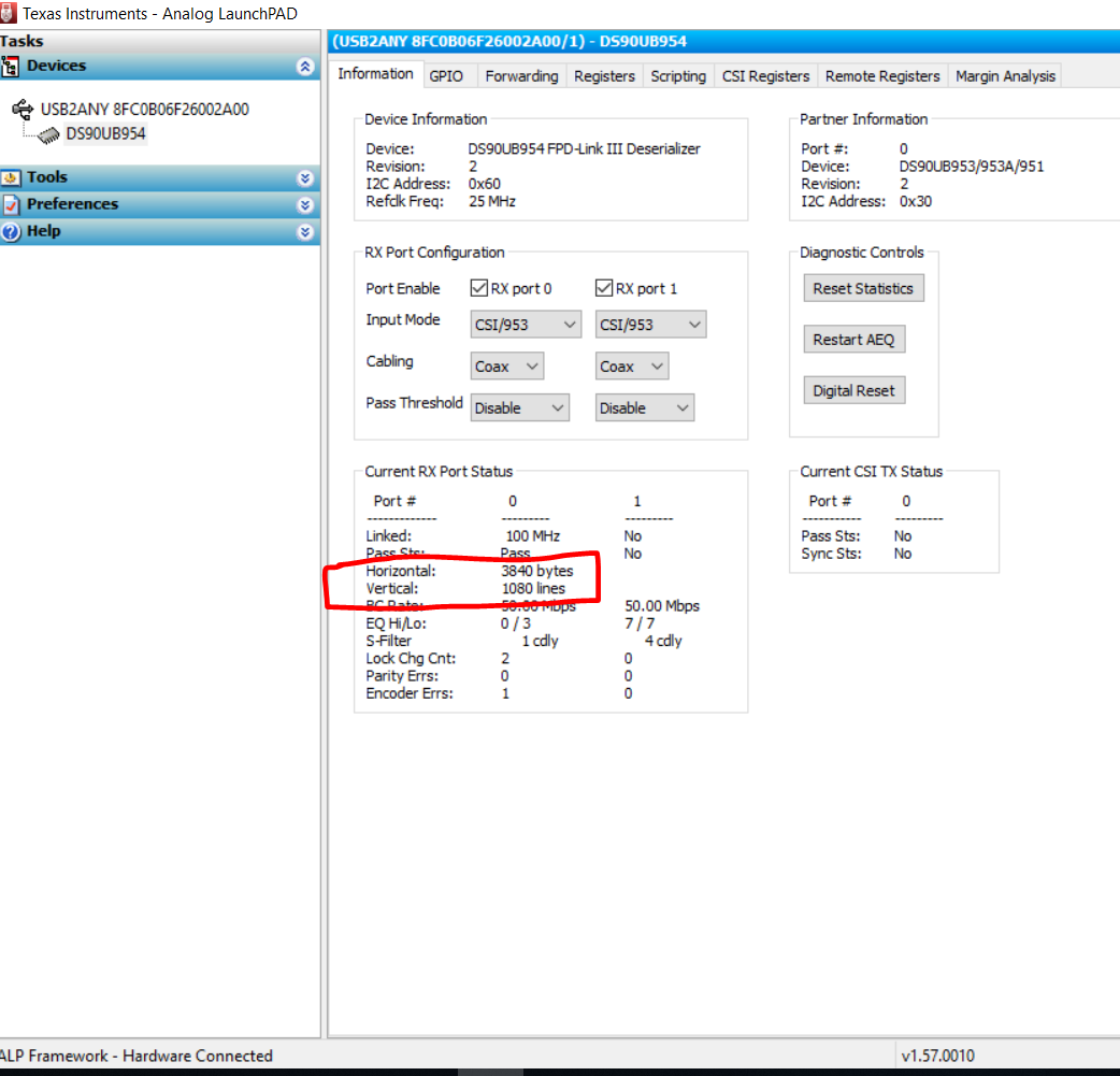

    # Patgen YUV ColorBar 1920x1080p30 on 953/954
    # Version 0.92
    import time
    # 953 config
    runTime = 3
    Alias953 = 0x18
    DES954 = 0x60
    # Reset 954
    board.WriteI2C(DES954, 0x01, 0x01)
    time.sleep(1.0)
    # CSI enable , continuous clock, 4 lanes
    board.WriteI2C(DES954, 0x33, 0x03)
    time.sleep(0.1)
    # Set CSI_TX_SPEED to select 800Mbps
    board.WriteI2C(DES954, 0x1F, 0x02)
    time.sleep(0.1)
    # Port Control
    board.WriteI2C(DES954, 0x0C, 0x83)
    time.sleep(0.1)
    # Port Selection
    board.WriteI2C(DES954, 0x4C, 0x01)
    time.sleep(0.1)
    # set alias
    board.WriteI2C(DES954, 0x5C, 0x18)
    time.sleep(0.1)
    board.WriteI2C(DES954, 0x20,0x00) # forwarding of all RX to CSI0
    time.sleep(0.1)
    if (board.ReadI2C(Alias953, 0x00, 0x01) != 0x30):
    	print "953 ID Error"
    else:
    	print "953 ID Ok"
    # Reset 953
    board.WriteI2C(Alias953, 0x01, 0x01)
    time.sleep(1.0)
    # enable pat gen
    board.WriteI2C(Alias953, 0xB0, 0x00)
    board.WriteI2C(Alias953, 0xB1, 0x01)
    board.WriteI2C(Alias953, 0xB2, 0x01) #enable pattern generator
    board.WriteI2C(Alias953, 0xB1, 0x02)
    board.WriteI2C(Alias953, 0xB2, 0x33) #fixed color pattern, 8 color bars, block size of 5
    board.WriteI2C(Alias953, 0xB1, 0x03)
    board.WriteI2C(Alias953, 0xB2, 0x1E) #CSI Data Identifier (0x24 = RGB888, 0x2C = RAW12, 0x2B = RAW10)
    board.WriteI2C(Alias953, 0xB1, 0x04)
    board.WriteI2C(Alias953, 0xB2, 0x0f) #line size (15:8)
    board.WriteI2C(Alias953, 0xB1, 0x05)
    board.WriteI2C(Alias953, 0xB2, 0x00) #line size (7:0)
    board.WriteI2C(Alias953, 0xB1, 0x06)
    board.WriteI2C(Alias953, 0xB2, 0x01) #bar size (15:8)
    board.WriteI2C(Alias953, 0xB1, 0x07)
    board.WriteI2C(Alias953, 0xB2, 0xe0) #bar size (7:0)
    board.WriteI2C(Alias953, 0xB1, 0x08)
    board.WriteI2C(Alias953, 0xB2, 0x04) #active lines per frame (15:8)
    board.WriteI2C(Alias953, 0xB1, 0x09)
    board.WriteI2C(Alias953, 0xB2, 0x38) #active lines per frame (7:0)
    board.WriteI2C(Alias953, 0xB1, 0x0a)
    board.WriteI2C(Alias953, 0xB2, 0x04) #total lines per frame (15:8)
    board.WriteI2C(Alias953, 0xB1, 0x0b)
    board.WriteI2C(Alias953, 0xB2, 0x65) #total lines per frame (7:0)
    board.WriteI2C(Alias953, 0xB1, 0x0c)
    board.WriteI2C(Alias953, 0xB2, 0x0b) #line period (15:8)
    board.WriteI2C(Alias953, 0xB1, 0x0d)
    board.WriteI2C(Alias953, 0xB2, 0x93) #line period (7:0)
    board.WriteI2C(Alias953, 0xB1, 0x0e)
    board.WriteI2C(Alias953, 0xB2, 0x21) #vertical back porch
    board.WriteI2C(Alias953, 0xB1, 0x0f)
    board.WriteI2C(Alias953, 0xB2, 0x0a) #vertical front porch
    board.WriteI2C(Alias953, 0xB1, 0x10)
    board.WriteI2C(Alias953, 0xB2, 0x00) #1st byte of fixed color
    board.WriteI2C(Alias953, 0xB1, 0x11)
    board.WriteI2C(Alias953, 0xB2, 0x00) #2nd byte of fixed color
    board.WriteI2C(Alias953, 0xB1, 0x12)
    board.WriteI2C(Alias953, 0xB2, 0xFF) #3rd byte of fixed color
    # board.WriteI2C(0xB1, 0x13)
    # board.WriteI2C(0xB2, 0xff) #4th byte of fixed color
    # board.WriteI2C(0xB1, 0x14)
    # board.WriteI2C(0xB2, 0xff) #5th byte of fixed color
    # board.WriteI2C(0xB1, 0x15)
    # board.WriteI2C(0xB2, 0x00) #6th byte of fixed color
    # board.WriteI2C(0xB1, 0x16)
    # board.WriteI2C(0xB2, 0x00) #7th byte of fixed color
    # board.WriteI2C(0xB1, 0x17)
    # board.WriteI2C(0xB2, 0x0f) #8th byte of fixed color
    # board.WriteI2C(0xB1, 0x18)
    # board.WriteI2C(0xB2, 0xf0) #9th byte of fixed color
    # board.WriteI2C(0xB1, 0x19)
    # board.WriteI2C(0xB2, 0x00) #10th byte of fixed color
    # board.WriteI2C(0xB1, 0x1A)
    # board.WriteI2C(0xB2, 0x00) #11th byte of fixed color
    # board.WriteI2C(0xB1, 0x1B)
    # board.WriteI2C(0xB1, 0x3f) #12th byte of fixed color
    # board.WriteI2C(0xB1, 0x1C)
    # board.WriteI2C(0xB2, 0xc0) #13th byte of fixed color
    # board.WriteI2C(0xB1, 0x1D)
    # board.WriteI2C(0xB2, 0x00) #14th byte of fixed color
    # board.WriteI2C(0xB1, 0x1E)
    # board.WriteI2C(0xB2, 0x00) #15th byte of fixed color
    # board.WriteI2C(0xB1, 0x1F)
    # board.WriteI2C(0xB2, 0x00) #16th byte of fixed color

    In our system, we have no display and let the SoC to handle data.
    So, we can not directly confirm the image generated by the pattern generator.
    We want to use a pattern generator to analyze the data and see if the data in each pixel is as expected.
