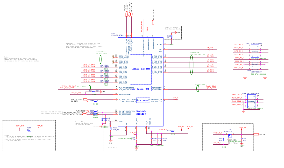

             The topology is NB-> typec connector -> Mux -> DP130 -> Monitor. If NB output four lane DP, the monitor will be light up normally. But if NB output two lane or one lane DP, monitor fail to light via DP130.

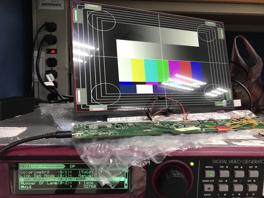

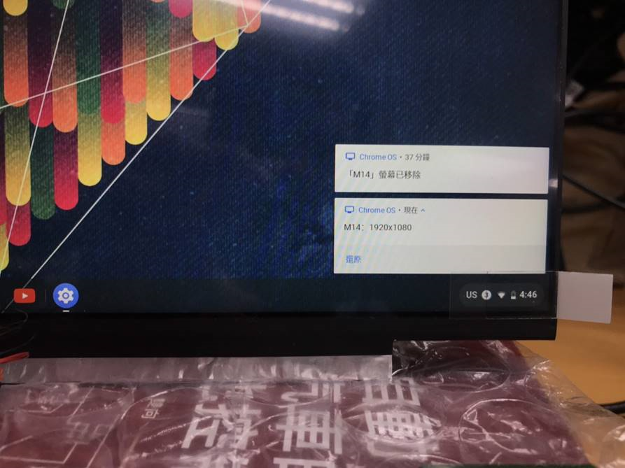

              After bypass DP130, Customer use Google NB output 2 lane and 1 lane DP, the monitor will light up normally. If use Astro VG-870 (DP to Type C cable Pin assignment E), the monitor still light up normally.
              Why two lane and one lane not light up monitor via DP130? Thank you.
Google NB(Chrome book)
1366x768@60Hz
800x600@75Hz(HBR 1 lane)

  • Hello David
    Yes. But customer bypass DP130 while at 2 lane and 1 lane then monitor light up. So it should not related to lane switching due to DP130 already bypass, right?

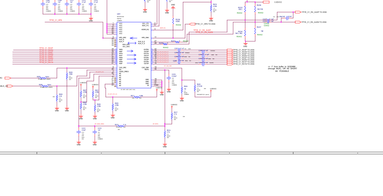

    Another question, if DP0+ input to IN- pin of DP130, DP- input to IN+ pin of DP130, but output will also OUT- pin output to DP0+, OUT+ pin output to DP- simultaneously as above DP130 schematics. If do polarity swapping on DP130 input/output pin, has any issue while 2 lane or 1 lane? Thank you.

    When bypassing DP130, are they also bypassing the 10G Mux? I don't have the datasheet for the 10G Mux so I can't comment on how the Mux handles the Assignment E lane mapping.
    If the polarity matches between input and output, then this is not an issue.

  • Hello David
    Customer use RTS5450 for 10G mux. Do you have datasheet to confirm lane mapping correct or not for above schematics? Thank you.

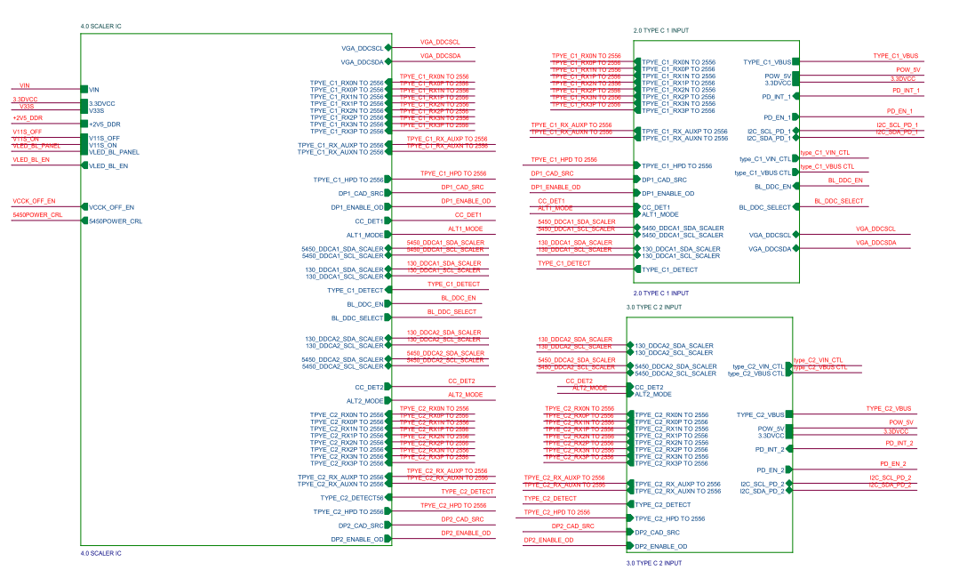

  • Hello David
    per check with realtek Mux, it is not support Pin assignment E. Assignment E is setting on Scaler internally. So this should be the issue root cause. Thank you.

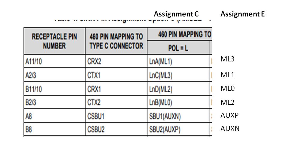

    Since I don't have the Realtek Mux datasheet, I am going to use HD3SS460 datasheet to illustrate the difference between Assignment C and E.
    The graph below shows the Assignment C and Assignment E normal plug lane ordering.
     For Assignment E, ML0 will be mapped to B10/B11 and ML1 will be mapped to A2/3. But assume the MUX only supports Assignment C, then B10/B11 is mapped to ML2 and A2/3 is mapped to ML3. In the schematic, I have to assume the MUX is muxing ML3 to Type_C1_RX2P/N, which is then connected to DP130 LN2, does the Scalar recognize this?
    Besides the lane ordering difference between Assignment C and E, the lane polarity and AUX polarity are also swapped between Assignment C and E, but I am assuming here that the Scalar is aware of the polarity swap since the 4 lane works.
    The clock experiment they did is a good experiment, they should have a clock at each Type C input (TX1/2, RX1/2) and see which DP130 output has the clock and then have the Scalar map it accordingly.
