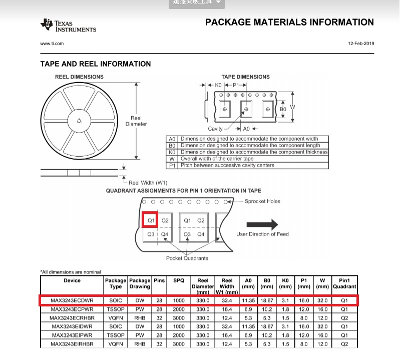

Hello
Could I know IC PIN 2 position one below red mark? Thank you. ~
