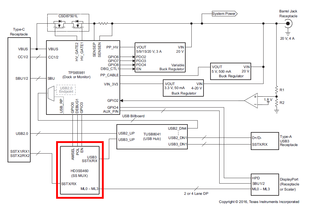

Dear Team
My customer is asking whether TPS65981 need additional switch to support DP/USB3.
The additional switch my customer is considering is PS8743.
But my understanding is that TPS65981 has integrated the function of PS8743.
could you please help confirm this?
thank you
  • Hello Eric,
    Yes, they will need an additional switch to support DP/USB3. The TPS65981 has a built in MUX, but only for the USB2.0 connections (D+/D-). There is a reference diagram shown within the datasheet highlighted below. You can try to push a TI solution of the HD3SS460, or the latest variation of this part.
    Hope this answers your question! If so, please click THIS RESOLVED MY ISSUE
