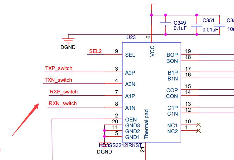

Hi:
Customized card: AM5748
SDK: processor-sdk-linux-am57x_04_03_00_05
How do I find the software setup section for TUSB322I?
Is there a user manual for type-c?

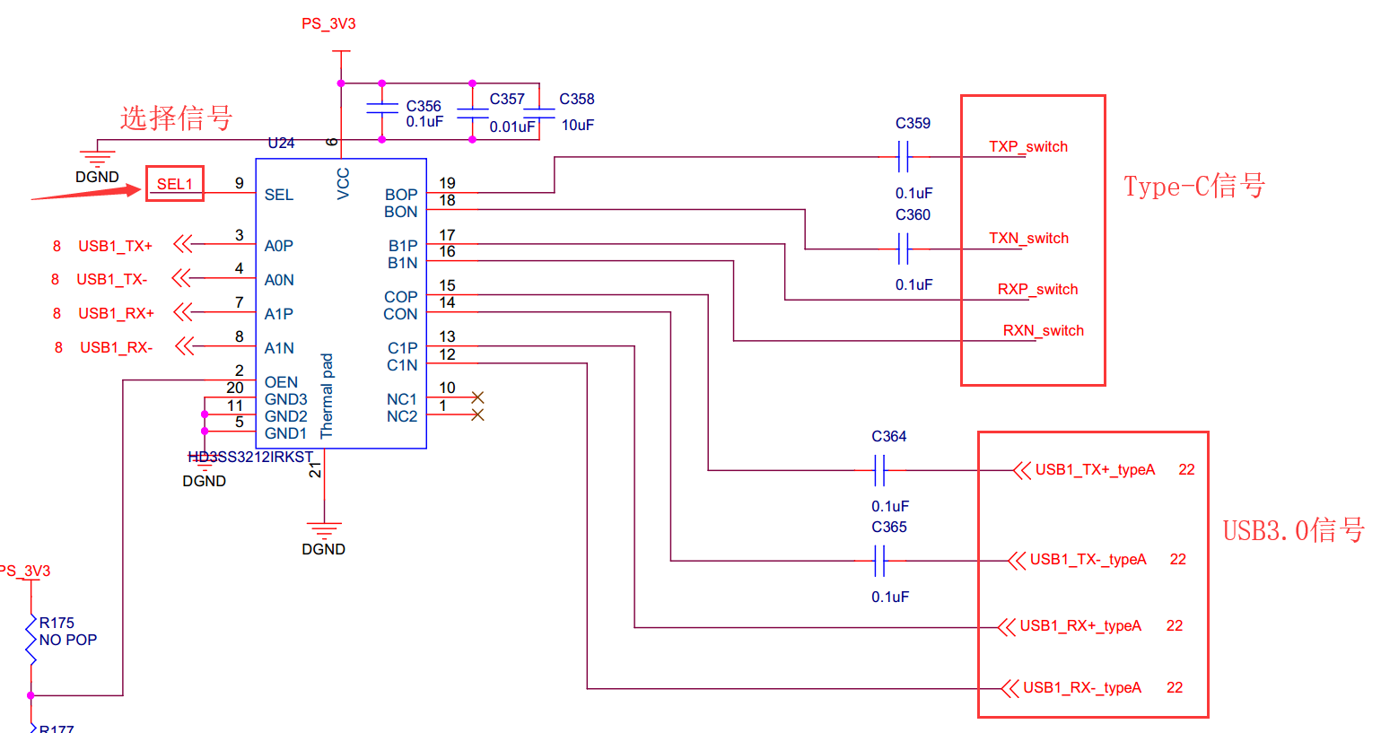

The following figure is about the typeC and typeA signal selection.by hd3ss3212:

Hi:
Refer to the HD3SS3212 manual to find that only 0.1 capacitors need to be added to the TX terminal between the chip and the connector.
I am using two HD3SS3212 chips now. Then, between the two chips, it is necessary to add 0.1 capacitors to both the TX and RX terminals?
Should TX / RX between HD3SS3212 and main chip AM5748 increase 0.1 capacitor?
Hi:
Whether the B0P of the HD3SS3212 chip can be connected to the TX1P or TX2P on the typeC interface. Or B0P can only be connected to TX1P, and C0P is connected to TX2P. Unable to connect TX2P to B0P ???
