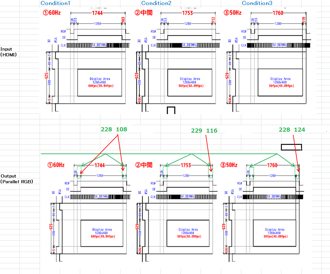

Hello team,
I have question about TFP401A. The in and out put signal which is DE and HSYNC relation is difference between DE and HSYNC. Is it correct operation? Could you refer the attachment?
If yes, why the DE and HS signal difference? According to the data sheet of TFP401A, HSYNC is automatically reproduced from the input signal to absorb HSYNC jitter on the HDMI side. Is this due to this behavior?
