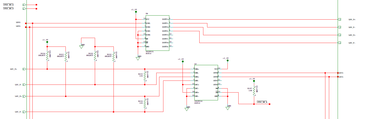

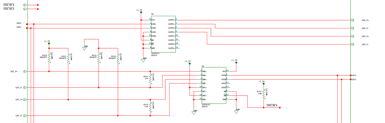

1) In failure situations, the circuit configuration is as follows.
external_image

  • Sujin,
    Unfortunately the image showing schematic did not get posted.
    In order to post an image, click on the "Insert Code, Attach Files and more..."
    Then select an image or file with the paperclip icon to insert.
    Based on this limited data, what was state of enable signals for application and during testing?
    Wade
  • Sujin,
    This seems very unusual.  The schematic shown should not be harmful to the drivers.
    Are there any of the issues?  Power supply spikes or overvoltage?
    What temperature in the chamber?   Duration?  Is there any thermal dissipation through board?
    Did the device start out working, then fail?
    Your schematic does not show biasing of the enable lines.
    Did these units get sourced from a TI authorized distributor?
    Wade

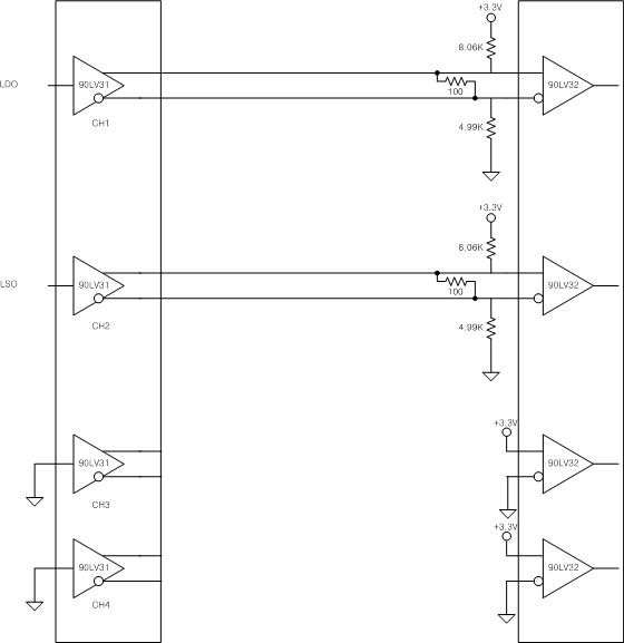

  • As upper block diagram, we designed 100 ohm parallel resistor and, 8.06K pull-up, 4.99K pull-down
    And it is same that driver GND & Receiver GND.

    Sujin,
    I don't see anything wrong with your biasing and setup. This should not be damaging to the device.
    Exposure to vacuum should not impact electrical performance of device.
    Exposure to vacuum will limit the ability for device to dissipate heat through the air. If device is not mounted to board to allow conduction of heat to the board, then it may be possible that device is overheating and not allowing enough cooling through the leads or through board when in vacuum.
    You mention 0.7A at 5V.
    This device operates at 3.3V. Did you mean 3.3V?
    How many devices are being supplied by the 0.7A? Do you know the dissipation of the Driver?
    Can you place thermocouple or other means to measure temperature of the device while under vacuum?
    Can you apply thermal paste to board to insure good conduction to board from device(s)?
    Other possible option is that devices were electrically over stressed by non warranted third party rescreening.
    Wade
