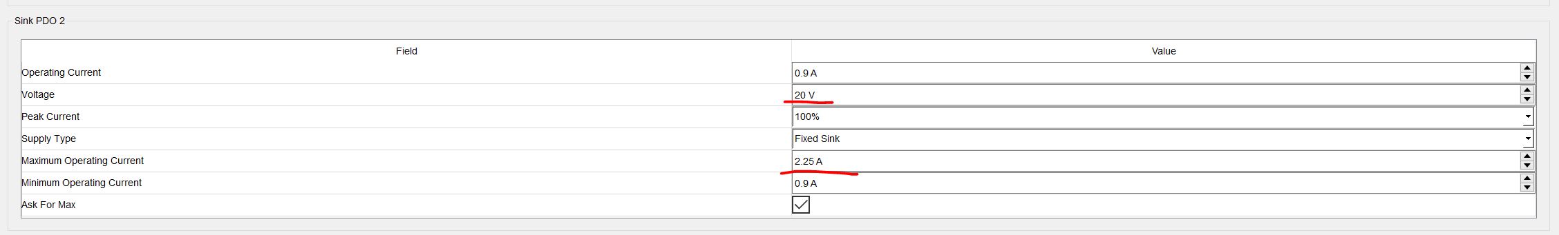

I would like to use TPS65987D GPIO event to differenate below 4 kinds of adapters.
1. 20V/3A, 60W
2. 20V/2.25A, 45W
3. 15V/3A, 45W
4. 12V/3A, 36W
I am thinking to set 4 fixed sink PDO in sink capabilities and then use "Port 0 Source PDO 0 Negotiated" to indicate which PDO is negotiated. Could you help comfirm if this works? If not, do you have other recommendation? Thanks.
