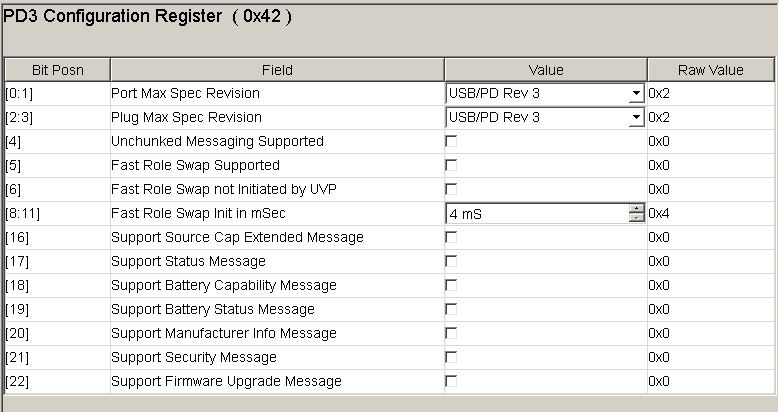

2.  I'd like to set "Chunking_Implemented declared as 0".
    I use 987D as PD3.0 supported.
    Even if I set 0x42 like the following picture, the test result was "1".
   How should I set 987D FW to set "Chunking_Implemented declared as 0"?

    2. The VIf spec states "If PD_Specification_Revision is not set to 2 (Revision 3.0), then this field shall be ignored by testers." The PD v 3 spec requires Chunking to be implemented for compatibility (reference see 2.3.2 Compatibility with Revision 2.0).

    2. The Application Config tool can set PD spec supported (PD3 Configuration Register). Chunking is a requirement when PD rev 3 is active.
