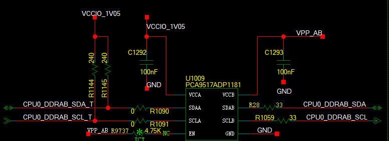

My customer use the PCA9517 as below:

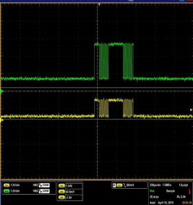

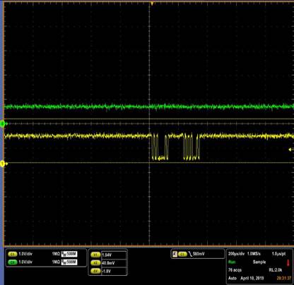

But there is no SDA signal in SDAB side, the test results are as blow. The SCLK are all OK in A side and B side.
Yellow is the SDAA, green is SDAB
The yellow is SCLKA, green is the SCLKB.
Can you help to review the schematic and comments what may be the cause for this?

    Can you please ask the customer for more images of the surrounding circuitry? For example, I do not see pullup resistors on the B side of the device. Based on the SCLK signals it appears as though they exists, but on the SDA image the B side does not appear to be high in steady state. Note that when undriven, the lines should be pulled up to their respective VCC.

    The pull up resistor in B side is 2K.
    So now it seems the B side has went into a stuck state and the voltage is keeping as 0.7V all the time.
    Reset or power cycle will not cover the failure state.
    And only this device can reproduce this failure.
    Can you help to analyze what may be the cause? Is there some circuit damage that can cause this failure?

    My customer have replaced the PCA9517 with a PCA9617, the issue is still. So it seems it’s not a single chip failure issue.
    They have also changed the R28 to 0 ohm and removed the R28, the SDAB still don’t have signal and it’s in low level all the time.
    Please help to double check the schematic and the issue wave.
    Can you help to comment what may be the cause? They have checked the other circuit and can’t find any suspect cause.
