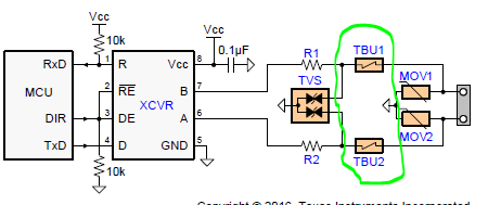

Part Number: SN65HVD888
As per SN65HVD888 datasheet recommended for Transient Protections Against ESD, EFT, and Surge Transients. Accordingly we have provided R1, R2, TVS, TBU1,TBU2 and MOV1, MOV2 components in our design for protection.
One of the reference notes recommended to connect Fast Acting, 3-Electrode 420 V Gas Discharge Tube (2030-42T-SM-RPLF) with respect to GND and data lines.
Is it require for our protection? because RS485 bus network/wiring GND connection is not mandatory, mostly D+ and D- only connected in bus wiring. (chances to miss GND connection in bus cable wiring).
Please provide your suggestion for the same. we need to protect from 230V AC power cross.
