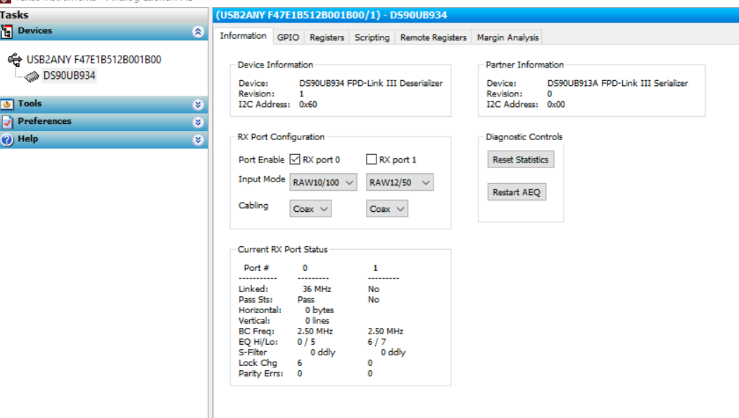

I used Ds90UB934-Q1EVM to connect customer board. I found it can detect the customer board and the lock led and link led are both light. But can not read the customer board register. So how to solved the problem?

If everything is ok but the I2C still failed, you can check it step by step:
1. back channel is working? you can capture the signal in the FPD-Link, whether the back channel and forward channel signal are mixed together? if NOT , pls check the reason.
2. if item1 is ok, pls read the i2c signal in the 934 EVM side, and the 933 camera module side as well, checking whether the ACK has issue or the signal is NOT transmitted from 934 to 933?
