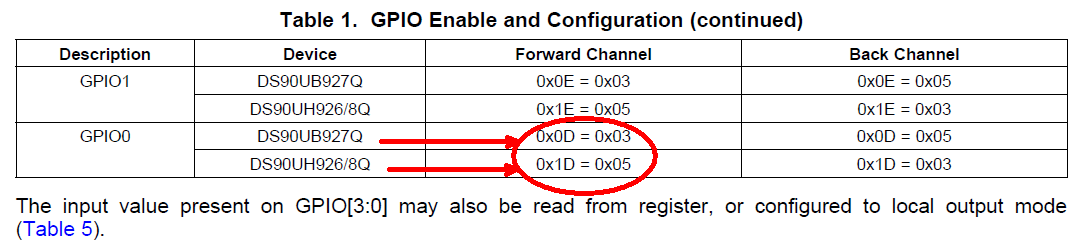

At present, ds90ub927 is used as serializer and 928 as de-serializer. Link is MCU - > 927 - > 928 - > touch screen
I accessed 927 on the MCU side. The I2C address is 0x0c. It is possible to read the value of 0x00 registers as 0x18, which is correct.
928 I2C address 0x34, access this 0x34 directly with mcu, read the value of 0x00 register is wrong.
Touch screen address is 0x38, access this 0x38 directly with mcu, read the register inside is also wrong.
How do I configure 927 to access 928 and the touch screen behind 928?
