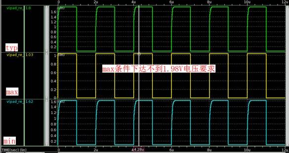

  • Hi Max,
    My customer use the module do the simulation, but it seems the output level of the max condition is only 1.03V, the typical and min condition are correct.
    PCA9306_IO_18_S Model_type  Series_switch。
    Input waveform
    Output waveform
    Can you help to double check the module the max condition output level?

  • Hi Lacey,
    Sorry for the delay - I was out of office the end of last week.
    Can you please share your circuit set-up for this test? Primarily I would be interested to see how you've implemented the pull-up resistances, since these are required for proper operation.
    Also, which simulation tool are you using? (I believe the handling of series switch models like this can vary from tool to tool.)
