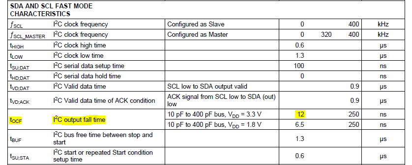

Our customer is using TPS65987D and wants to ask a question.
In TPS65987D datasheet, the I2C output fall time minimum is 12ns (fast mode).
But what they measured is about 2-3ns. It is out of spec for them.
They want to know if there is any impact or side effect if the I2C fall time too fast?

    Customer may want to check the capacitance on the line or trace layout.
    While I2C is a low speed interface, I need to warn that it is still out of spec and there is a chance that fall time in this range (2ns) can lead to transmission line or signal integrity issues in the system.

    Sorry, I want to confirm that what does the "I2C output fall time" mean in our datasheet??
    Is it the output spec for master or input spec for slave??
    I do agree that this is specified as an output value for a given range of bus capacitance and pull up voltage. I would double check bus capacitance, pull up resistor and any series resistance.
