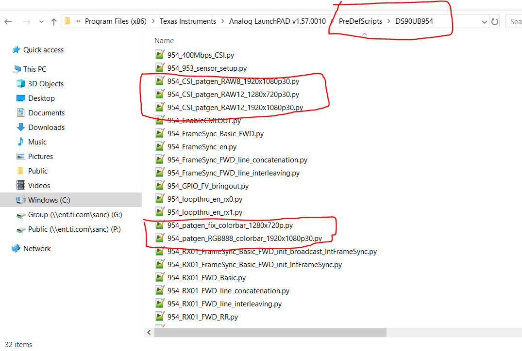

HI,
I enable Pattern Generation ,when I set reg.0x33(CSI_CTL) to 0x01,Pattern Generation work well ,csi2 clk lane and data lane both have signal and I can cee color bar.
But when I set reg.0x33(CSI_CTL) to 0x03,Pattern Generation not work. I've checked the signal of csi2 clk lane and data lane. data lane have signal ,.but csi2 clk lane no signal  and can't see color bar.
When I enable Pattern Generation  with  CSI continuous clock mode. Do I need to set up other registers? or Are there other places to pay attention to?

    There are a number of sample patgen scripts available as part of the ALP Install folder. Please install latest ALP from TI.com and take a look a the following folder.
    Vishy

    When you connect with ALP tool and check your board for successful SERDES setup you should see as shown in sample screen shot below.
    Vishy
