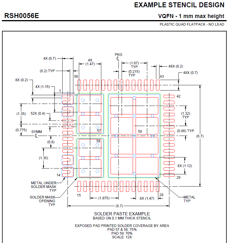

Customer is using 0.13mm thick stencil and found there is 1% to pin short between pin1 to pin2 (although they do short internally), but appearance is not allowed.
Could you please advise stencil design for 0.13mm thickness stencil?
