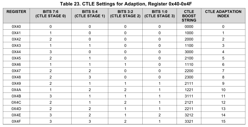

Could you please disclose the boost setting (gain) of each value in the following table ? How much dB at 5.5GHz or 5GHz ??

The DS110DF111 and DS125DF111 share a common CTLE design. The 6.25 GHz boost value is given for the DS125DF111 in the datasheet on page 33 . The value for the DS110DF111 at 5 or 5.5 GHz will be very similar (< 1dB lower).
