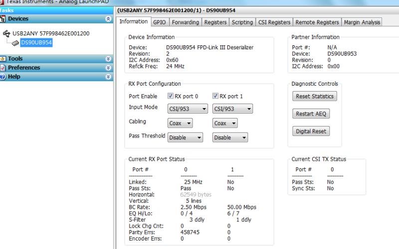

My customer USES the ds90ub954/953 design, but there is a problem at present, 954 cannot communicate with 953. At present, 954 of the customer can be connected to 953EVM, but 954EVM cannot be connected to 953 of the customer.
I then grounded the other end of the DOUT's coupling capacitor, which now seems to be connected, but with a strange problem. The following figure shows the action after Analog LaunchPAD is connected.
What could have gone wrong
