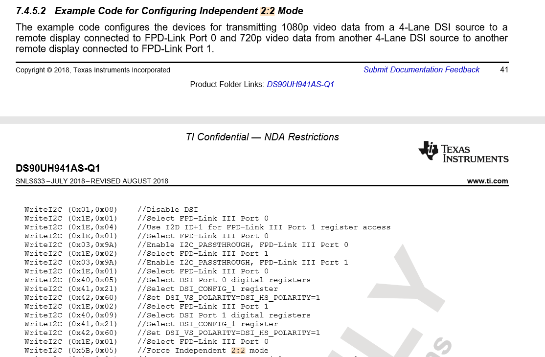

Hi team,
    My customer use DS90UH941 device for display application and the display resolution is 1080p60. They would use dual link to send the video data. So they would like to get example code for 2:1 mode for the reference, like the example code (2:2 mode )as below. Could you please help to provide the example code for this requirement? Thanks a lot!
