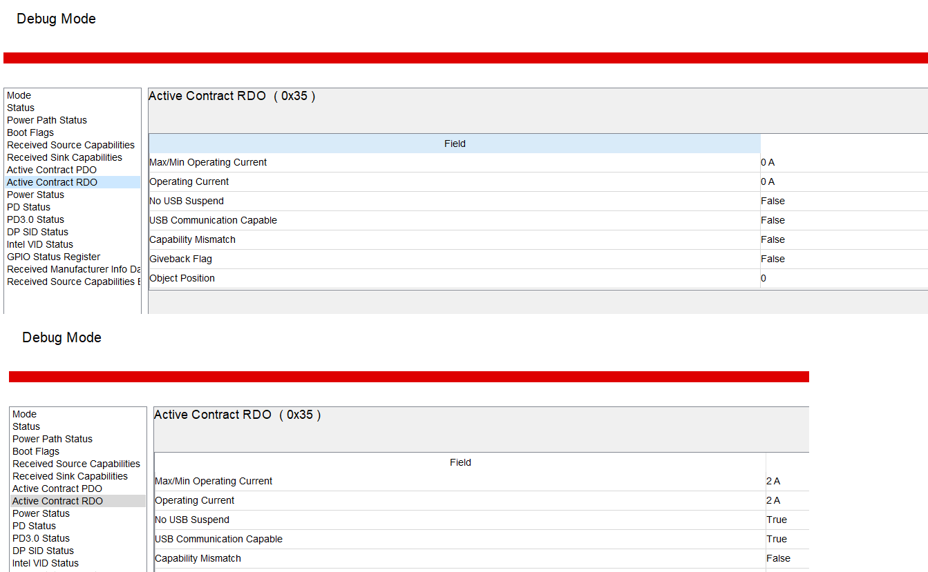

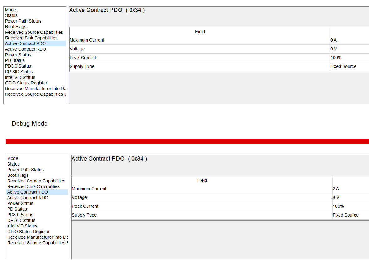

      we use our board as source, and use TPS65987EVM as sink, to debug whether SOURCE device can charge 9v to SINK device ,
here is these two boards's config
TPS65987D-Source.pjt
TPS65987D EVM_SINK_Upstream-facing Port.pjt
when I use TPS65981_2_6_7_8 Application Customization 5.1 to debug sink device(EVM board), I saw Active Contract RDO(0x35) is always switcheing from 0A to 2A,
and Active Contract PDO(0x34) is always switch from 0V/0A to 9V/2A
  • Hi Carson,
    It looks like the device you are connecting supports a 9V/2A PDO. I'm not sure exactly what the issue is, are you seeing VBUS go away and come back?
